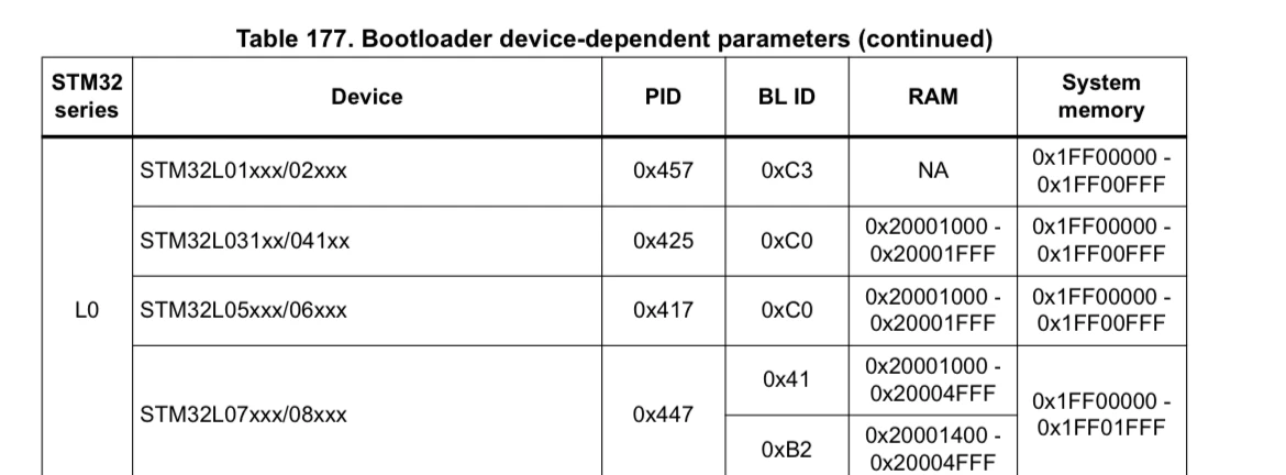

STOne-32
Feb 27, 2024 4:07 AM UTC
Dear @MSipo ,
looking at our AN2606 , that address memory is not readable by the embedded bootloader on top of the main Flash/Data user area :
https://www.st.com/resource/en/application_note/an2606-stm32-microcontroller-system-memory-boot-mode-stmicroelectronics.pdf#page407
1FF8xxxx where are the Unique ID is not inside .
Cheers,
STOne-32

STOne-32
Feb 27, 2024 4:44 AM UTC
Dear @tjaekel ,
Embedded bootloader is programmed only by ST and done at Factory, it is not a user code that can changed or modified. It has specifications as mentioned in AN2606 such as using RS232 commands and Allowed addresses inside are bounded depending on devices .
Of course if using a user code or SWD any address is accessible if not Protected .
Hope it helps you .

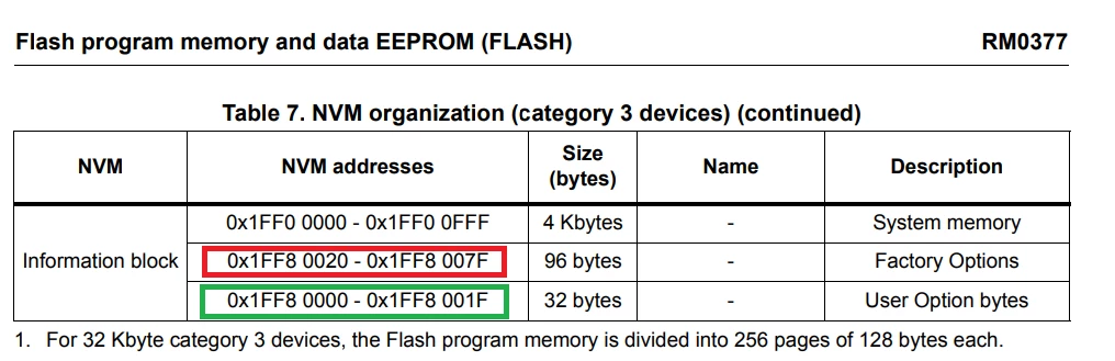

MSipo
MSipoAuthor
Senior II
Feb 27, 2024 8:53 AM UTC
Update:
I have tested some more here. These are the results:
These reads work:
  • Read 128 byte starting from 0x1FF8 0000
  • Read 97 byte starting from 0x1FF8 001F
  • Read any individual byte between 0x1FF8 0000 to 0x1FF8 001F
Does not work:
  • Read 96 byte starting from 0x1FF8 0020. Or read anything starting from 0x1FF8 0020
  • Read any individual byte between 0x1FF8 0020 to 0x1FF8 007F
Looks like a bug in the bootloader. It will only accept the read if the first address is between 0x1FF8 0000 to 0x1FF8 001F.
Any thought about that?
