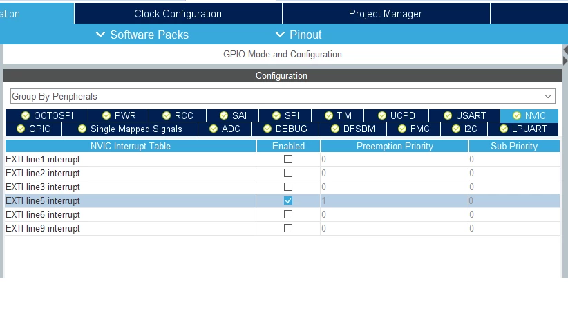

Attached STM32L5 NVIC configuration:
KnarfB
Aug 11, 2020 12:48 PM UTC
In the generated file stm32l5xx_it.c should be an EXTI interrupt handler generated dispatching control to your callback. You can set a breakpoint there and step through. What pin is your button? The default USER_BUTTON is PC13 not 5.
