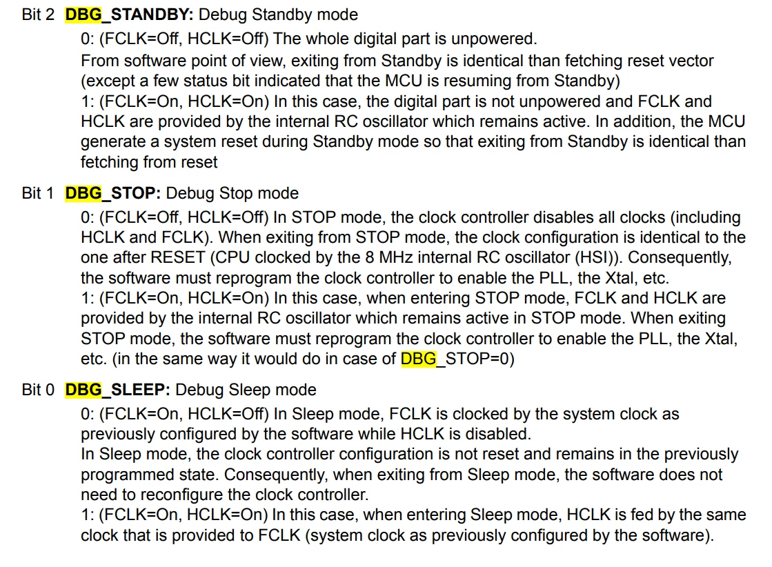

I am working with STM32 U575/U5A5 and L4 series of STM32 controllers in low power mode. I have programmed the controller to wake for every 10s and blink LED. This issue what we observed is once  immediately flashing hex file to controller using STlink programmer, Controller is not entering in sleep mode LED will be keep on blinking. If I remove the power and connect it back, Controller is entering sleep mode and waking up for every 10s as expected.
we have reseted the controller using Reset button, but still controller is not entering to sleep mode.
The question here is why Controller requires  power on reset to enter power saving mode after flashing hex file to controller using STlink programmer?

Your issue is very simple. You prog MCU with debug in low power mode set. This config DBG register and this isnt overide with reset. Only power off or in code change register DBG... or in your IDE set no debug in low power...

Really? as far as I know, debug in low power mode can increase current consumption (until you POR), but it doesn't actually mean you take the MCU out of sleep mode. Do I have it wrong?

Right, but OP is not about current reduction, or even low power modes (non-native speaker, so admittedly hard to parse). It's about programming the chip and having the new program seemingly not taking effect even after a manual reset. Only after a POR is performed.
Since LP debug mode should not effect the observable runtime behavior (docs say it's there so you can set breakpoint on wakeup ISR while CPU is in low power mode), the answer given by MM..1 still makes no sense to me.
@MM..1  says I'm wrong. I wish he would explain why.

Simply MCUs is in totaly different state
but in detail you dont get here info how low power mode used, Based on your code config wake is from timers systicks usw.
Andrew Neil
June 28, 2024
So the MCU does still behave the same as if went to sleep - you just don't get the power reduction.
So this doesn't explain why @darshan-ltts does see different behaviour.
