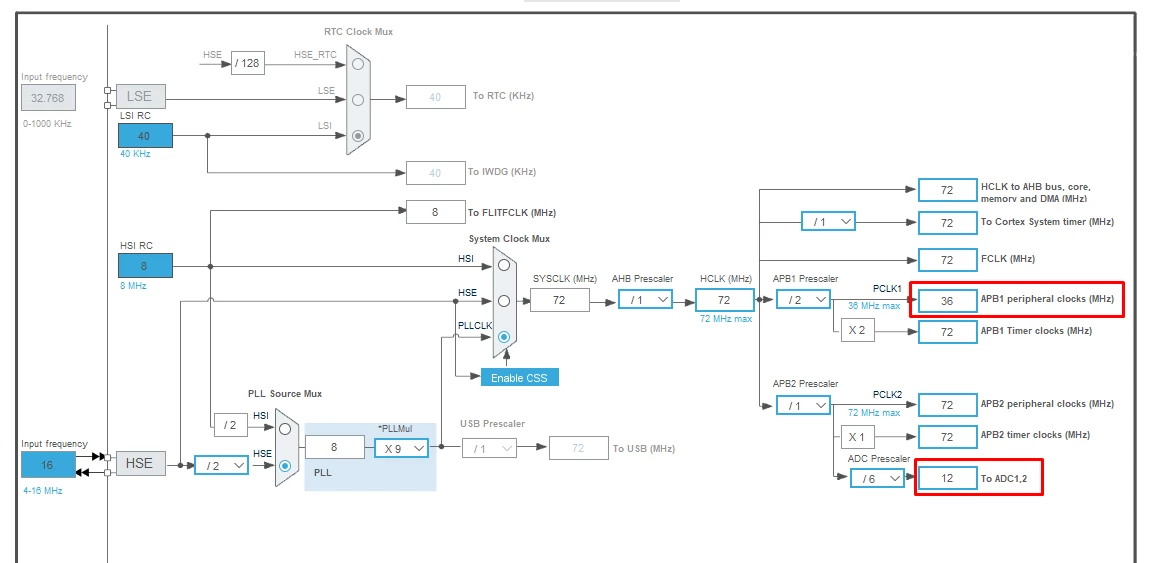

I am acquiring samples from 50Hz Sine Wave through a CT and want to get 100 samples of this signal (T=20ms). For this, I need each sample at 200us apart so I get an array of 100 bytes. I have following clock setup:
APB1 = 36Mhz; ADC = 12Mhz
TIM3 Event: 36,000,000/ 7,200 = 5,000Hz = 200us
ADC Sample Time: Sampling Time + 12.5 cycles = 239.5 + 12.5 = 252 cycles => 1/12Mhz X 252 = 21us

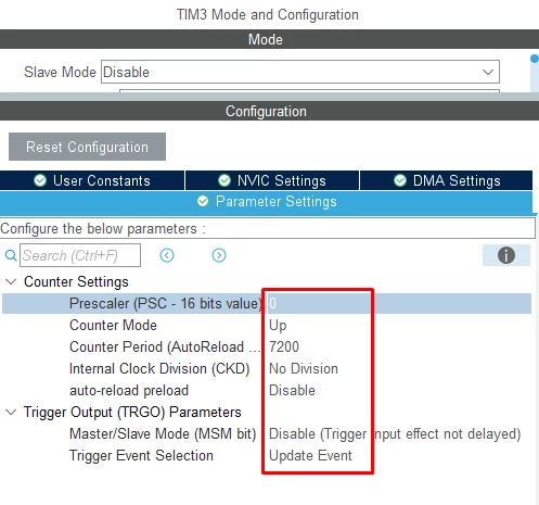

TIM3:

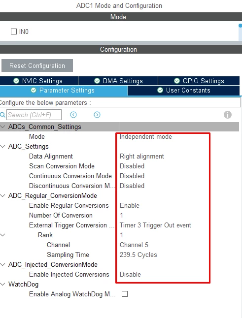

ADC:
Screenshot_46.pngUsing above settings & calculations, SOC is supposed to complete said ADC in 21us and sample time is 200us which is fine. Here is the code:

sConfig.Channel = ADC_CHANNEL_5;
 sConfig.Rank = ADC_REGULAR_RANK_1;
 sConfig.SamplingTime = ADC_SAMPLETIME_239CYCLES_5;

 htim3.Instance = TIM3;
 htim3.Init.Prescaler = 0;
 htim3.Init.CounterMode = TIM_COUNTERMODE_UP;
 htim3.Init.Period = 7200;
 htim3.Init.ClockDivision = TIM_CLOCKDIVISION_DIV1;
 htim3.Init.AutoReloadPreload = TIM_AUTORELOAD_PRELOAD_DISABLE;
/* TIM3 Config */
I am getting samples in the 400 byte array but I am supposed to get a complete sine wave cycle in first 100 byte but the cycle is completed in 200 bytes. Even I tried to increased sampling time (Counter Period: 14,400) it shows same the result. Here is the samples vs. data result:

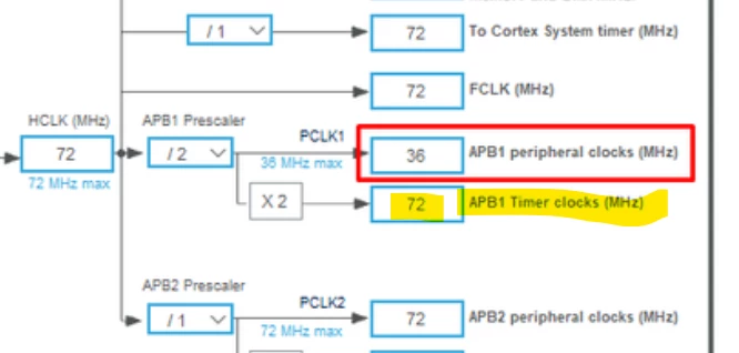

> But how come 14400-1 is giving 200us period?
Oh, now that I understand the issue you're describing, the answer is easy:
The timer clock is 72 MHz, not 36 MHz.
14400 / 72 MHz = 200 us.
This all checks out, yes?

It looks like you have 2 complete sine waves in 200 samples, which is 1 per 100 samples, yes?
Counter period is off by one. It should be 7199.

x4ceAuthor
October 1, 2024
Yes, I have missed that and mistakenly considering 36MHz as Timer 3 clock as well. Thanks for pointing out.
