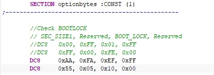

I tried with below method
In .s File added below lines to
	SECTION optionbytes :CONST (1)
 //Check BOOTLOCK
 // SEC_SIZE1, Reserved, BOOT_LOCK, Reserved
 DC8	0x80, 0xFF, 0xFF, 0xFF
 DC8	0x7F, 0x00, 0x00, 0x00
 END

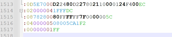

In .icf file added below lines
define symbol OPTSTART = 0x1FFF7828;
define symbol OPTEND = 0x1FFF782F;
place at address mem: OPTSTART { ro section optionbytes};
BOOT_LOCK option bytes values are appended in hex file as below in 0x1FFF7828 location

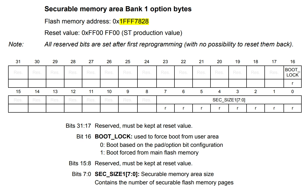

The 0x7F000000 value you're putting in doesn't match the table you've provided or what's in the reference manual. If you want BOOT_LOCK=1, and SEC_SIZE1=0, then you should write 0xFF01FF00 for the 32-bit option byte or 0x00FE00FFFF01FF00 for the 64-bit register.

In my question, value is 0xFFFFFF80, were BOOT_LOCK is 1 and SECSIZE1 is 0x80
for 64 bit value is 0x0000007FFFFFFF80,

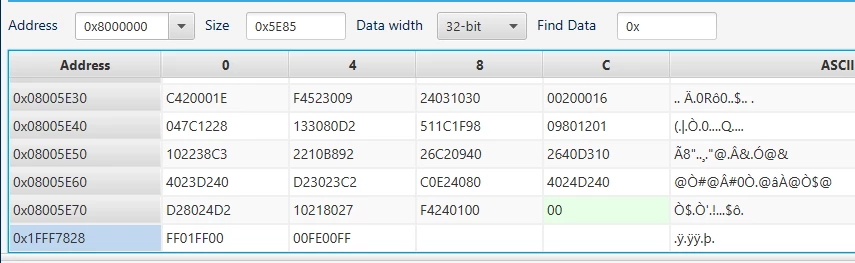

Anyway, i tried as you suggested and below is the stm32 cube programmer snapshot
but no luck, am i missing something..?

I didn't mention it before since you said other option bytes were "working", but how are you setting OPTSTRT to actually program the option bytes? The registers in RAM are just the interface, they don't control the values stored in FLASH, at least not directly. Presumably this scheme might work if OPTSTRT is set last, or set by some other mechanism.

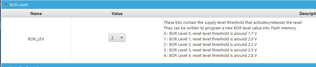

below changes are to modify BOR value to "2" and it worked without OPTSTRT
BOR_LEV changed from 0 to 2

Okay, could be two things going on here, but the more important point is that option bytes do need to be written with OPTSTRT in order to write them to nonvolatile memory, otherwise they will be reset when the chip gets reset. STM32CubeProgrammer is just reading from the registers and doesn't know if they've been written correctly or not.

I repowered MCU and read, BOR_LEV value didn't reset, it remains as 2
