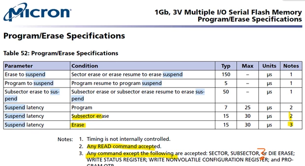

maybe this is bit off-topic, but does anybody know if it is possible to suspend an ERASE operation and write to another (previously erased) sector?
I want to save a page in flash in case of a power outage and want to interrupt a probably ongoing ERASE.
If so, is this possible in internal flash or only in external flash?
In our design there are 2 QUAD SPI NOR flash connected to the dual QSPI- and one QUAD SPI NOR to a SPI interface of the STM32H75x. It would be surely possible to write to an idle flash while the other is busy erasing a sector. But it would be nice if write-while-erase-suspended would work on a single flash.

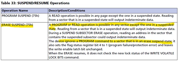

The documentation of flash is confusing e.g. in the MICRON flash, which is soldered on the STM32H753_EVAL board, it seems there is difference in sector erase and erase command:

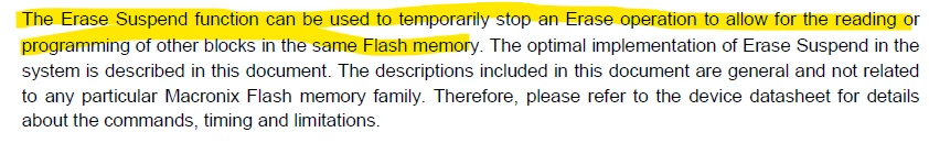

The MACRONIX AN0247 says that programming is allowed

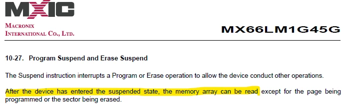

but the datasheet says that only read is allowed in suspended state

Got my suspend/resume test working. I experienced two problems with the MT25QL. First, writing to flash after erase suspend works not for 4kB sectors. Now I use 64kB sector erase. Second, the program must wait for the WIP bit cleared after erase suspend before issuing a page write. It is not sufficient to wait for the erase suspend bit set only. The MT25QL maintains a negated copy of the WIP status register bit in the flag register. So both bits must be verified by reading the flag register. First I did not wait for WIP cleared and the following write did not succeed. The write seemed to be ignored because the program failure bit was not set.
