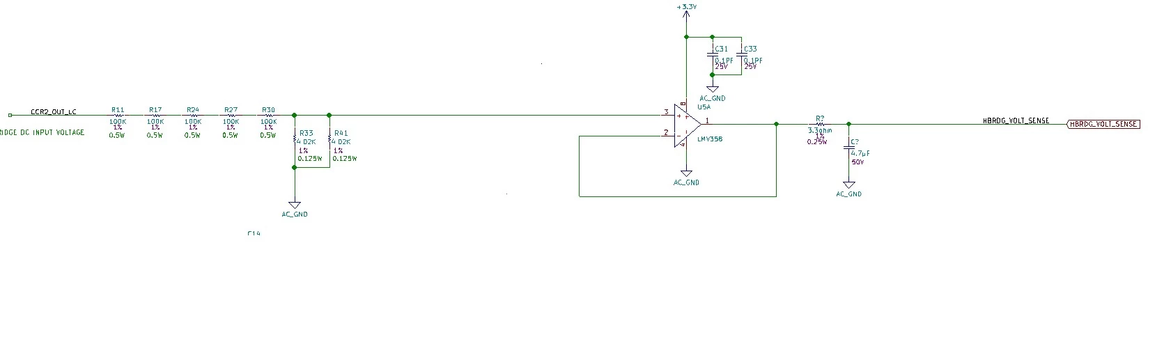

    ADC input hardware is as shown below for measuring voltages at range of 350v dc

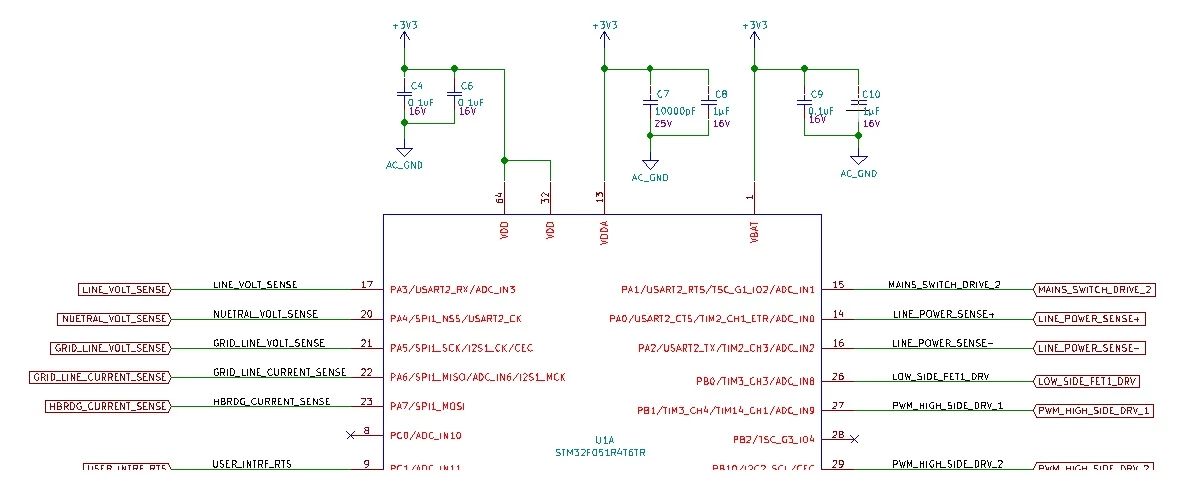

    The above given is the power supply configuration given to the stm ic
    I can't see anything below. Guess you need to klick the "Image" icon and upload an image.
    Simple copy and paste doesn't really work with this forum.
    Anyway, 350V sounds like a significant amount of adaption and galvanic isolation circuitry.
    Try to validate both separately. Presenting low-impedance fixed voltages to the ADC inputs should yield reasonable results.
    Have you measured the transfer behavior of said adaption circuitry with a reference voltmeter ?

    I'm not a hardware guy, but 4.7uF at the opamp output /ADC input seems an awful lot to me.

    Is that a battery ?
    remove C9 from the battery..
    it looks a very simple circuit.
    the OPAMP wont like going anywhere near the rails. @Avatar has eluded to this.
    you will find that different opamps will give you different results at the rails.
    if you could use a +/- 5v supply, then the opamp will be ok,
    then you need input protection diodes.. to stop the -5V blowing up the processor...
    otherwise choose a Rail to Rail opamp from Analog Devices.. and pay for the good one...
