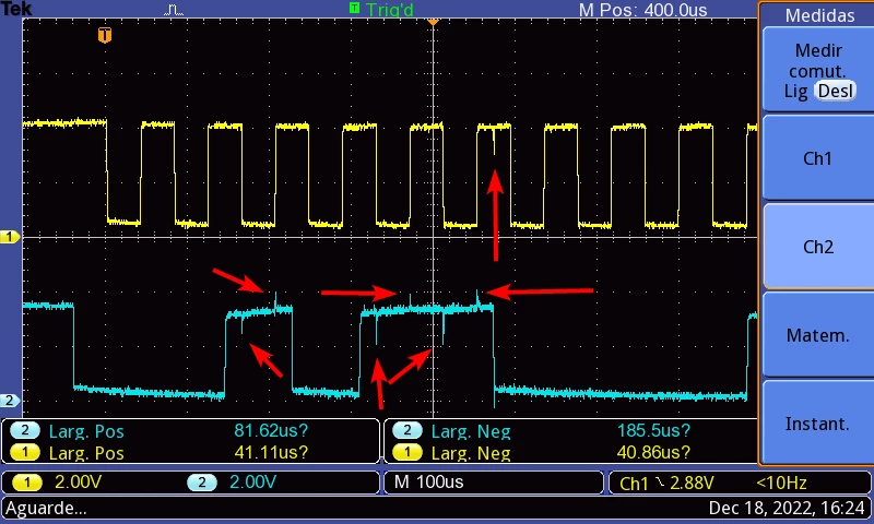

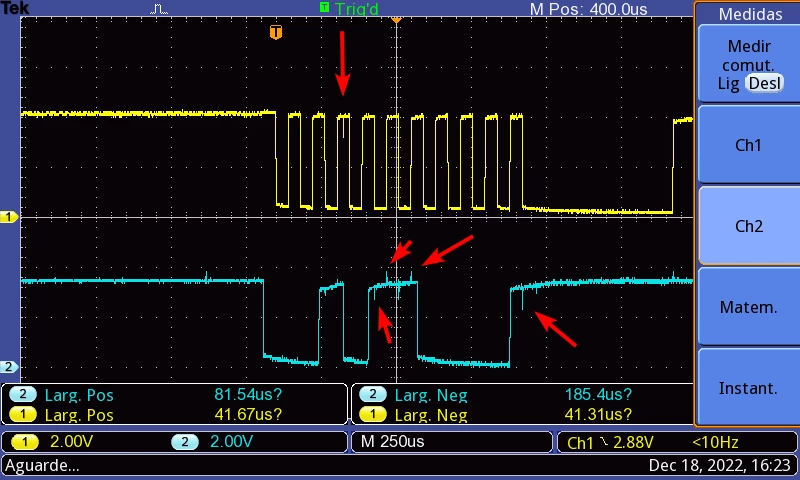

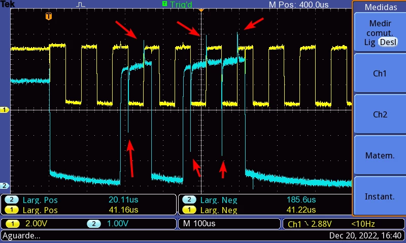

Hello guys, I have a problem with my project. I'm development the PS/2 (device, keyboard-like) protocol with my STM32F103C8T6 (Bluepill). When i convert my port to the open collector output, the noise appear in the PS/2 bus. In this moment, the STM32 controll de clock/data bus. I used open-collector to control de bus. I have a 10K resistor to pull-up the bus.
For exemple: (0x1A data every second)
0693W00000WLT39QAH.png 0693W00000WLT3EQAX.png0693W00000WLT3xQAH.pngBasically, this is my routine to generate the clock and data:

I don't know what is causing these noises. :worried_face::worried_face:
When I use the push-pull output the noise disappears... But, this is not recommended.

you pics show a strong capacitive coupling between clk and data ( y + cyan) , so separate the lines or screen them separately;
if using a flat cable , try : gnd/clk/gnd/data/gnd . so get some "screen" by the gnd lines.

otavio.maciel
Dec 20, 2022 11:51 PM UTC
I'm using the protoboard, maybe it's the low quality of it. I will check this and I return with news! :thumbs_up:
otavio.maciel
Dec 21, 2022 12:12 AM UTC
The problem is the protoboard! Thank you very much for help! :(
Piranha
Principal III
Dec 21, 2022 1:09 AM UTC
Maybe you created some ground loop, which can be a problem.
