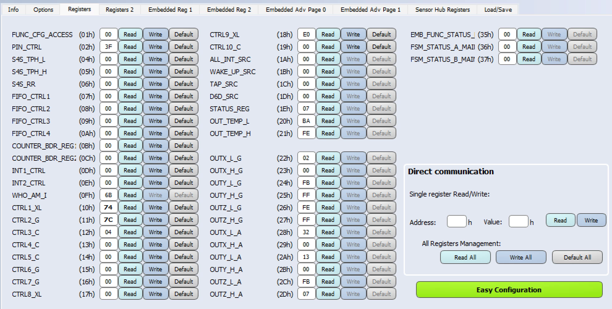

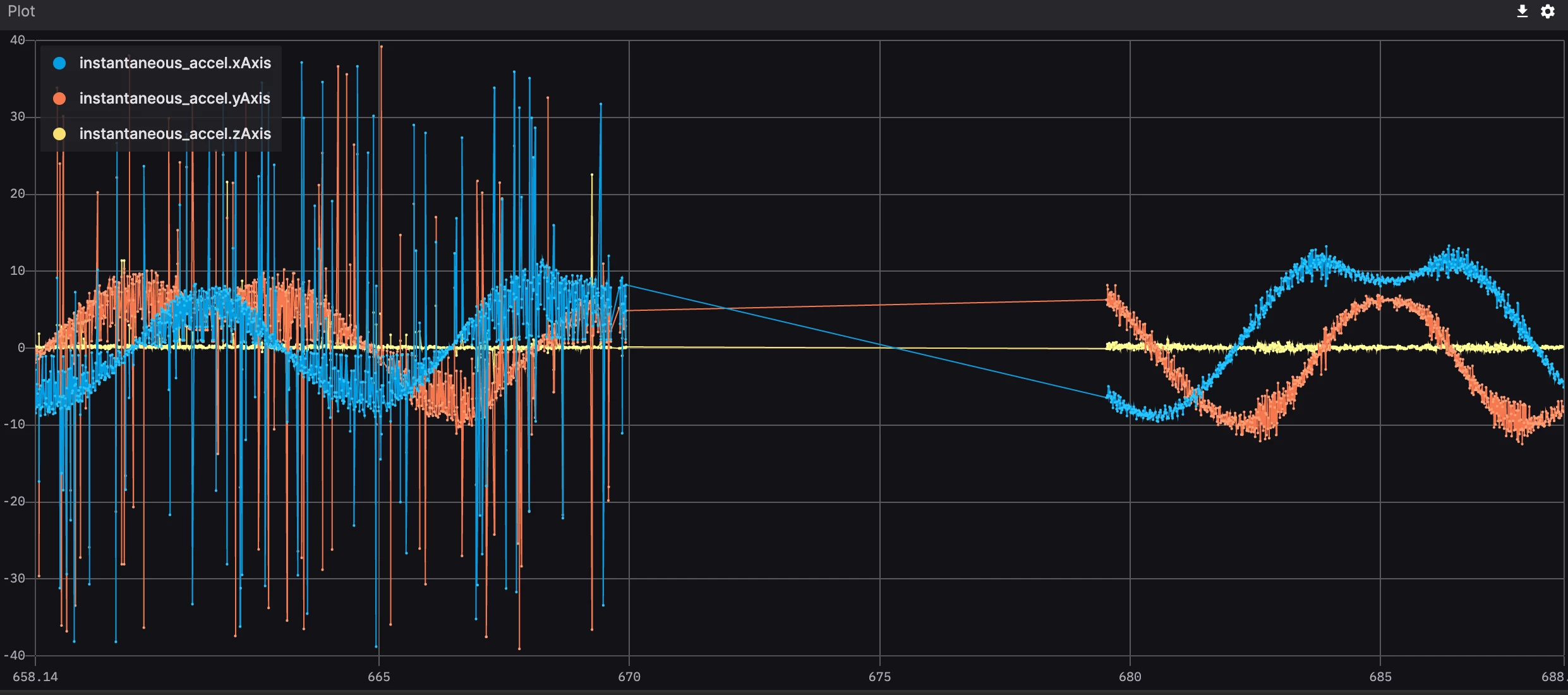

Hi All,
I'm interfacing LSM6DSR IMU with STM32H745 over I2C (1mbps). The accelerometer data looks good and consistent with pretty low noise.
However, as soon as I configure the Gyro as well to turn on - the accelerometer has really wild noise.
Attached three pictures with:
  1. Accelerometer plot - left part with gyro enabled and right with gyro disabled
  2. Configuration registers values which I confirmed with ST Unico tool

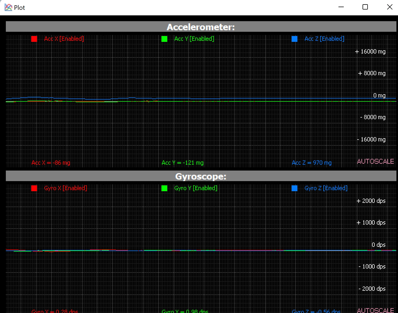

  3. Plot of accelerometer and gyro on the STEVAL-MKI194V1 with Unico tool and shows no noise
Any pointers on what could be wrong ? I can only use I2C since the hardware is already designed.
