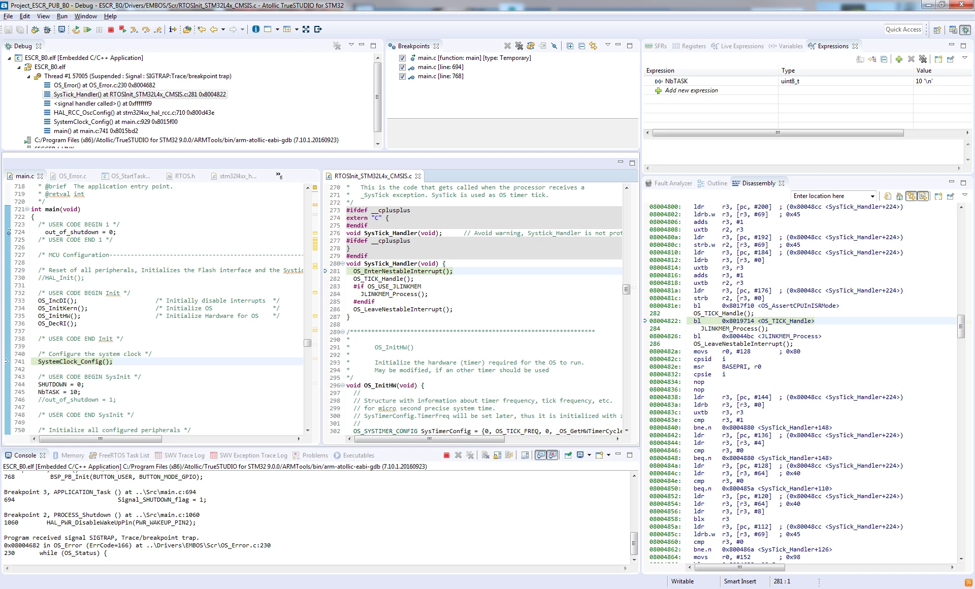

Here the screenshot after a battery deconnection. The wake up should work properly but it is stuck in SysTick_Handler!
Tel me if you can see the picture!!!
Any ideas ?

Ozone
Principal
Sep 3, 2019 9:00 AM UTC
You should have told that an OS (presumably FreeRTOS) is involved.
First, the terminology is not clear.
If you disconnect both VDD and Vbat, the MCU is basically power supply. Reconnecting it constitutes a POR, not a wakup.
No system states (variables, values) are defined then, and need initialisation (done in the startup code before calling _main).
Caps on the board might keep some RAM cells and register values alive for a short period, but better not rely on it.
If the system hangs in the systick handler, you could possible check what goes wrong. Better switch to assembly mode, and check addresses and register contents.
Since (as I understand it) the code works after a hard reset (NRST), I assume skipped parts of the initialization (or reliance on unitialized values) is the culprit.

Piranha
Principal III
Sep 3, 2019 10:22 PM UTC
So the hardware works and the problem is purely software related... An the last lines in a console shows very clearly what has happened!
OS_ERR_CPU_STATE_ISR_ILLEGAL     (166 = 0xA6) *** OS-function called from ISR with high priority
Also, as You have commented out HAL_Init(), but are using HAL, then HAL_GetTick() & Co must be properly implemented in Your code.
