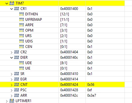

STM32G473VC, custom board.
I use an own bootloader which resides at address 0x00000000 , the user application resides at 0x00008000.
I did set external files correct to use the bootloader
in user application
system_stm32g4xx.c : #define VECT_TAB_OFFSET     0x00008000U

timer 7 is used as Timebase Source, FreeRTOS is also running.
We used this bootloader setup successfully in many other projects , but in this one the timer 7 interrupt stops interrupting if we jump to bootload code and back to user application.
This cause HAL_IncTick() not getting called, and uwTick staying at 0 . Which cause HAL_MspInit() ... HAL_SYSCFG_EnableVREFBUF() run in an endless loop.
The only different with other projects is that we use SPI in this bootloader to bootload , where we use UART in all other projects.
I checked the timer 7 registers which seems all fine .
0693W00000KZvjDQAT.pngthe strange thing is that both bootloader and user application runs correctly after a reset or power down - up cycle. Bootloader starts first and starts user application which runs fine. But when i use (SPI) commands to switch to bootloader and back to user application, then the TMR7 interrupt stops working.
What else can i check to find out why timer 7 is not firing an interrupt?

i have removed __disable_irq which i have added the past days in the bootloader code while i was searching for a solution... now it works.
i don't understand 100% why, i guess i need more knowledge about the STM32 NVIC interrupt system to know whats going on. But good documentation about this part is hard to get .

Do you set SCB->VTOR to the correct value within your application? Are interrupts enabled globally? Is the timer's NVIC interrupt enabled?

i've read all i can about NVIC and have found some extra information trough debugger.
The moment the interrupts are not firing NVIC_ISER1 has value 0x800100, which means EXTI15_10_IRQn and TIM7_DAC_IRQn interrupts are activated. While timer 7 DIER and CR1 registers are also correctly initialized .
The NVIC_ICER1 contains the same value.
NVIC ISPR1 and ICPR1 (pending set and reset) contains also set bits, while these are all 0 when everything works fine. Can that be the cause no interrupts are fired?
I did not find a way to reset these registers at the start of the user application.
I found out no interrupt at all is fired while i EXTI interrupts and TMR7 should interrupt. Is there a register which can block all interrupts?
