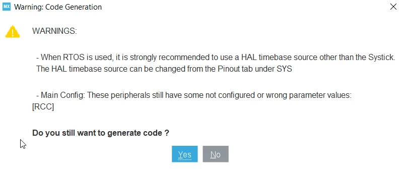

There also seems to have 2 issues before generating code :
Perhaps you could have a look at the application tick source guide .

The clock issue you mentioned is not related to SysTick issue. The one where RTOS recommends the usage of TIM instead of SysTick, is also not related.
Please read topic description very carefully. The one that breaks SysTick is __libc_init_array call. RTOS and TouchGFX are not even initialized at this stage.
