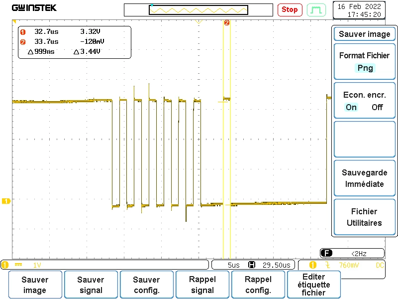

When i try so see frames with an osciloscope i get this :
0693W00000JQ3lXQAT.pngSo you can see the communication abort too early and i think it's because ther isn t stuffing bit.

Unfortunately, i can t send the whole project. but here is the clock configuration :
void SystemClock_Config(void)
 __HAL_RCC_PWR_CLK_ENABLE();
 __HAL_PWR_VOLTAGESCALING_CONFIG(PWR_REGULATOR_VOLTAGE_SCALE1);
 /** Initializes the CPU, AHB and APB busses clocks
 RCC_OscInitStruct.OscillatorType = RCC_OSCILLATORTYPE_HSI|RCC_OSCILLATORTYPE_LSI;
 RCC_OscInitStruct.LSIState = RCC_LSI_ON;
 RCC_OscInitStruct.PLL.PLLSource = RCC_PLLSOURCE_HSI;
 RCC_OscInitStruct.PLL.PLLM = 8;
 RCC_OscInitStruct.PLL.PLLN = 100;
 RCC_OscInitStruct.PLL.PLLP = RCC_PLLP_DIV2;
 RCC_OscInitStruct.PLL.PLLQ = 4;
 RCC_OscInitStruct.PLL.PLLR = 2;
 HAL_RCC_OscConfig(&RCC_OscInitStruct);
 RCC_ClkInitStruct.APB1CLKDivider = RCC_HCLK_DIV2;
 RCC_ClkInitStruct.APB2CLKDivider = RCC_HCLK_DIV1;
 HAL_RCC_ClockConfig(&RCC_ClkInitStruct, FLASH_LATENCY_3);
And the baud rate is at 1Mbit/s.
I also tested the same configuration in loopback mode and here i hadn't any problem, i received and sent valid frames. Moreover i had the good signal on Rx and Tx pin.
