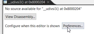

I'm trying a simple program with a modulo operator on a STM32G031 MCU. Everything works fine during launch. But when using debug, it says "No source code available for _udivsi3() at 0x08000204".
I know that the debugger is unable to find the source code because this MCU can't do hardware division. But I don't understand why the libC can't find any way to implement this. What is the workaround ? Is there a project settings I'm missing?

Only way I can explain the IDE/debugger halting there is if the IDE thinks you have a breakpoint set (perhaps from some previous debugging session).  I've seen this happen occasionally.  What version of the IDE are you using (or which IDE if not CubeIDE)?  You can try setting a breakpoint somewhere (anywhere), then select "delete all breakpoints" and see if that fixes it.
Hmmmm...  look at the call stack and see how it got to that function call.  That may give you a clue.

The debugger cannot find the source for that function because it is in the libm library, which only holds object code, no source files).  It doesn't mean the function doesn't exist - is obviously does since your program compiled and linked.  That is a software implementation of the divide instruction on the G0.  It just means that if you want to use the debugging to step INTO that function, you will have to use the disassembly window and step through the raw assembly instructions.

Ok many thanks for your replies. But there is still a behavior that puzzles me.
@Bob S I don't have any breakpoints anywhere, but the debugger stops by itself on this specific instruction (telling me that it can't find the source code). The problem is that the application breaks when restarting the debugger.
@Tesla DeLorean : No problem to debug yet, but if the debugger stops I won't be able to use it.

Thanks all for your help. As @Bob S  suggests, STM32CubeIDE > Run > Remove All Breakpoints did the trick. Can't believe it was so obvious but I really don't know how these BP set up at this address.

The absence of source shouldn't preclude the debugger from working, nor the stepping of code in assembler, at least until it gets to code for which it has source.
Libraries typically don't furnish source, at least directly, and may have paths to source that you don't have, or have some place else.
If the code is faulting, perhaps look at why that might be. Are you getting some usage fault due to an attempt to divide, or modulo, by ZERO?
