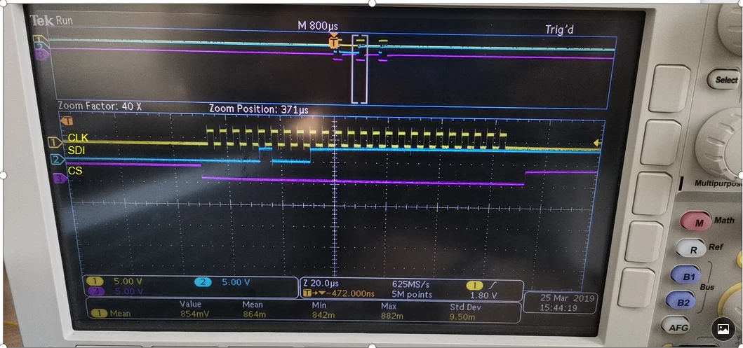

Hi,there.I am using DAC60508 with my STM32F7,60508 is 12 bits precision,and with 24 bits command-length,SPI interface. After initialize the SPI,I send 3 bytes separately,and I use a oscilloscope to check the wave of SCL�?SDI�?CS,its seems right,but i cant detect any output votage. This SPI2 code demonstrated working with another thermal chip.

Problem solved,the reason maybe that i didnt initialize one of the registers​
