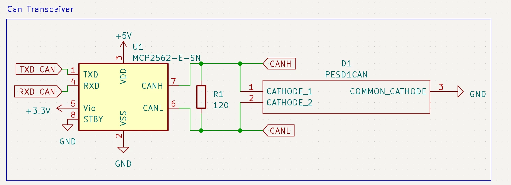

When debugging, all seems to go well, no errors. But when running the code, there never seems to be a CAN message on the line. Hardware connections are checked, and they're fine.
See Main(), message function and hardware connection below (added CAN init function too now):

This, is not a filter init routine. That's just initializing the Tx Header.
void CAN_TX_filter_init(void)
	TxHeader.StdId = 0x260;
	TxHeader.ExtId = 0;
	TxHeader.IDE = CAN_ID_STD;
	TxHeader.RTR = CAN_RTR_DATA;
	TxHeader.DLC = 8;
	TxHeader.TransmitGlobalTime = DISABLE;
This would be a correct filter init routine for the sFilterConfig which calls HAL_CAN_ConfigFilter.
And it includes calling HAL_CAN_ActivateNotification, which you are missing.

mƎALLEm
Apr 24, 2025 6:27 PM UTC
Not clear what do you mean by:
Do you mean when you start a debug session, you can see CAN messages on the line but when you run the application in standalone you cannot see CAN frames?
Also please clarify how are you checking the CAN message? which tool are you using?

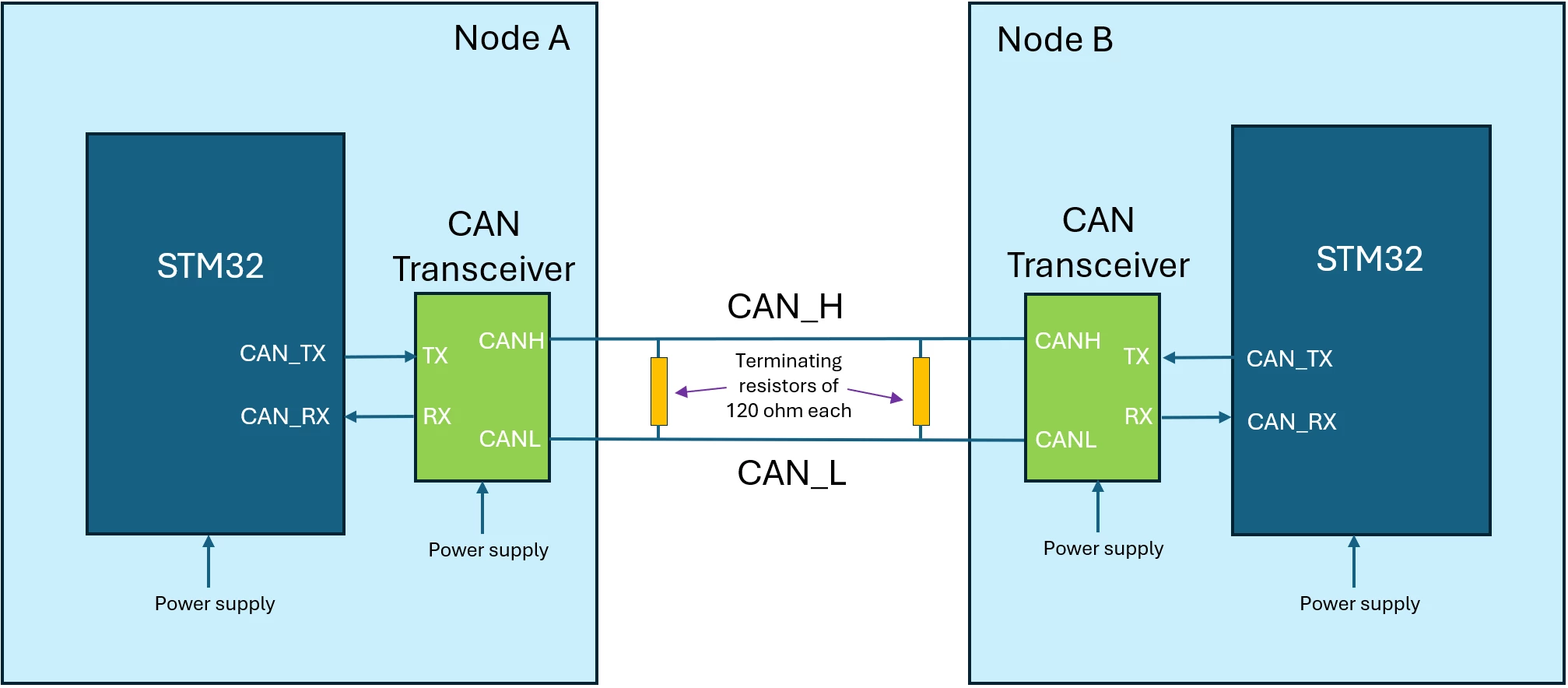

As you are using normal mode, did you establish a complete CAN bus like this?:
oguhAuthor
Apr 24, 2025 6:46 PM UTC
I've never received a CAN message from this setup. Not in debug mode or when running the standalone application. I check this using either a logic analyser or a different CAN node that can receive CAN messages. And yes, the picture you provided was my exact setup.
You need to check the filters and the NVIC interrupt. but sill not sure I've understood well the issue.
Is it an issue with both with the transmit and receive?
Please provide more details about the other node connected on the bus.
What is the bitrate are you using? are you sure you have the same bitrates on all CAN nodes?
	TxHeader.ExtId = 0;
	TxHeader.DLC = 8;
I didn't see it. Indeed that's not a Rx filter config. And as there is no filter config no message will be received if all the hardware and CAN config are OK. He needs first to start with loopback mode to validate the Rx and the filter config.
But still also he needs to confirm if there is an issue with Tx! as per the title "No message sent on CANbus line".
