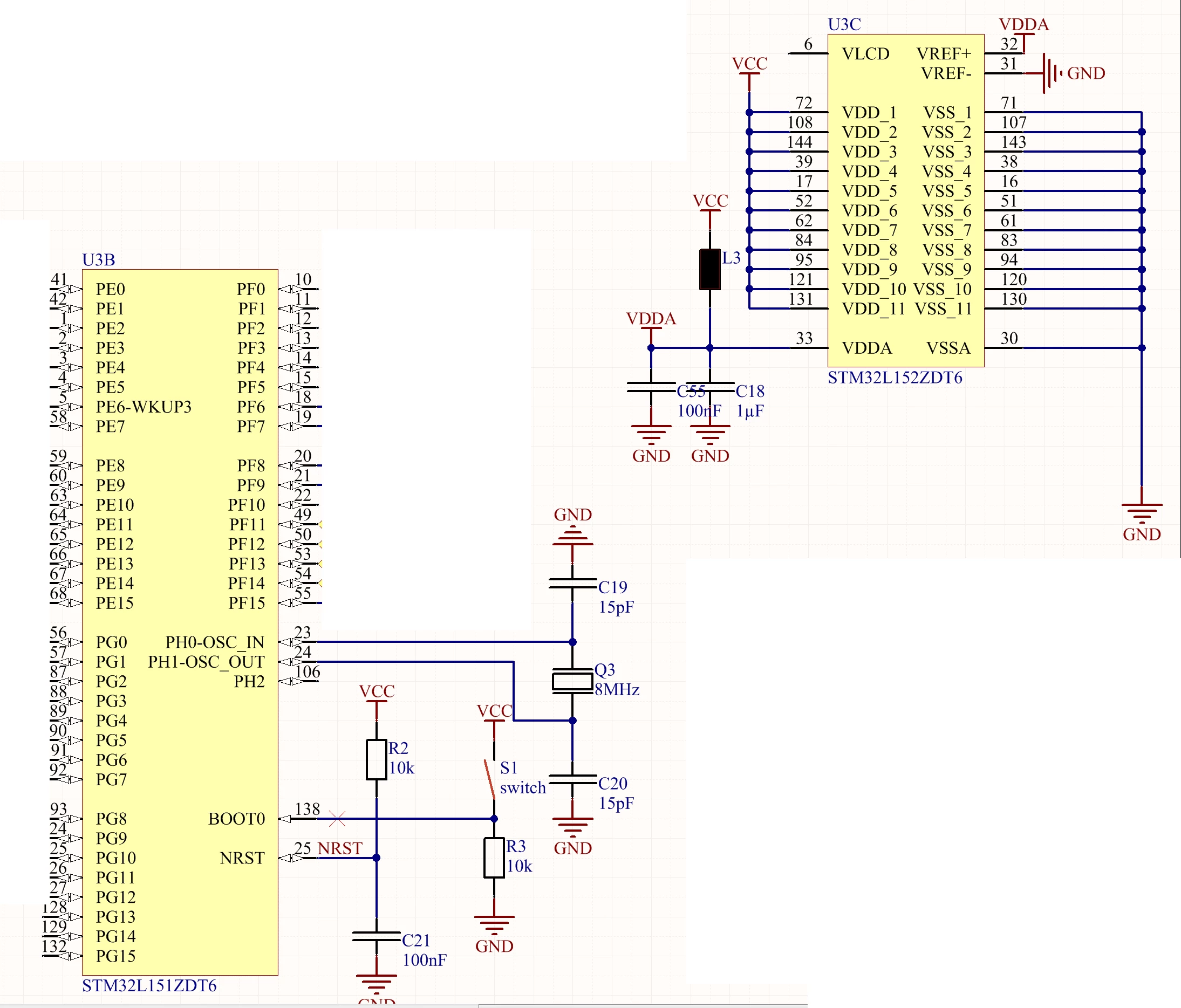

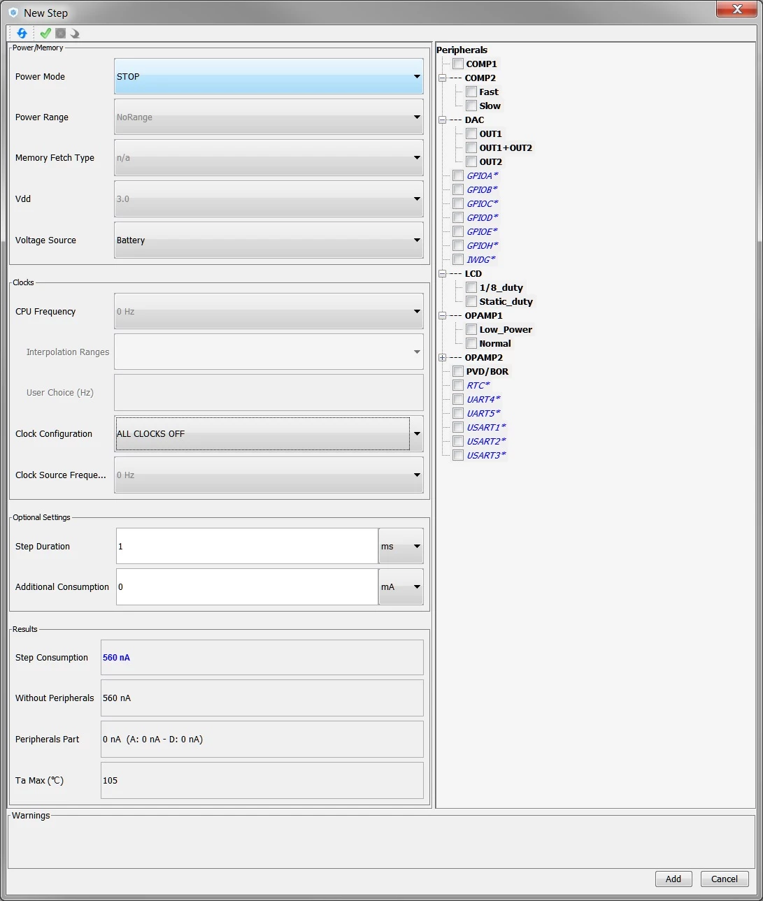

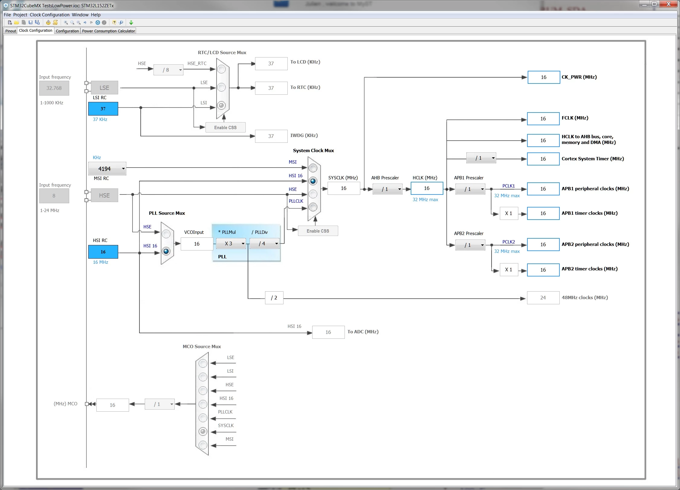

Hello
I can't succeed in getting very low consumption with the stm32L152zeT6. To be sure that it does not come from other components of my board, I built a new one and populated it with only the µControler and the related components which leads to the joined schematic. I used cubeMx to generate the code. Here's the clock page. I expect getting the estimation of cubeMx which is 500nA. Measurements are done without JTAG probe with a rigol DM3058E. CubeMx 4.1 and Cube 1.6. What can it be ? code ? configuration ? board ? bad estimation from cubeMx ? Thanks Julien Here's the code I wrote for main.

    Julien,
    have a look on RI_HYSCRx registers.
    Input hysteresis must be disabled to get low power figure. I don't known whether HAL manages them correctly. This is just a quick guess of what's might be wrong.

    Salut Laurent
    Thanks for your answer. Helpfull. 3-4µA less!
    Still 1.5µA to find... :D
    Thanks
