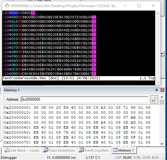

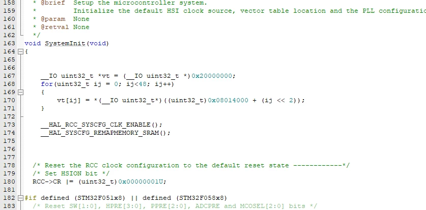

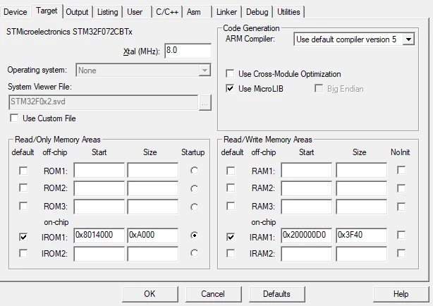

  1. Reserve the beginning 196 bytes of SRAM to store the Interrupt Vector Table. See ReserveSRAM.png. I did this in the beginning of SystemInit(). I've also tried it in the beginning of main(), failed the same.
  2. Copy the Interrupt Vector Table of the application to the beginning of SRAM. My application codes starts at 0x08014000. See CopyMemories.png.

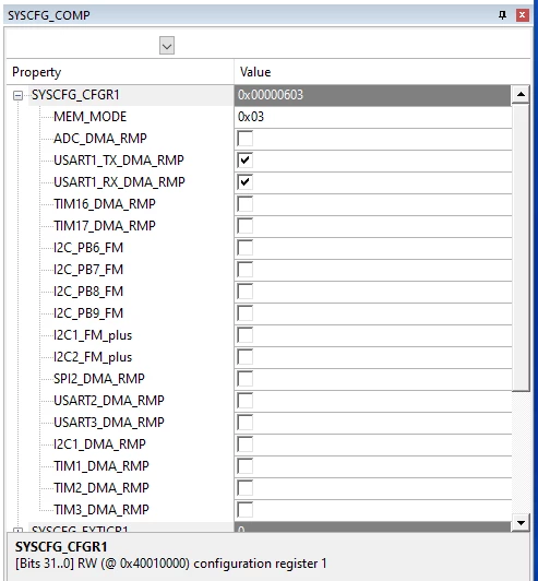

  3. Remap 0x20000000 to 0x00000000. See SYSCFG_CFGR1.png.

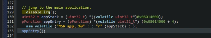

This is how I jump from the bootloader to the application:
typedef   void   (*pFunction)(void);
 // jump to the main application.
 __disable_irq();
 uint32_t appStack = (uint32_t) *((volatile uint32_t*)0x08014000);
 pFunction appEntry = (pFunction) *(volatile uint32_t*) (0x08014000 + 4);
 __asm volatile ("MSR msp, %0" : : "r" (appStack) : );
 appEntry();
I did disable all the interrupts before entering the main application. I could see that the jump enters to the Reset_Handler() of the main application.
Is this looked all right with you ?
And did you ever enable them again, most code assumes the processor starts with them enabled, because it does.
The "Disable The Interrupts" mantra in the context it should be used here is that you've turned them off at the sources, so the app doesn't suddenly have to deal with a mess that the loader left behind whilst lacking any initialization or context/instances. ie where is hUart3 and why is it USART3 interrupting..

> what I am missing here
__enable_irq()
