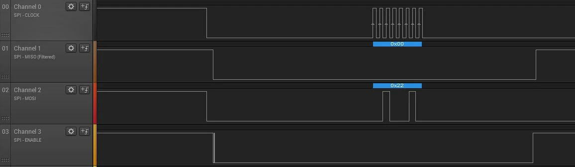

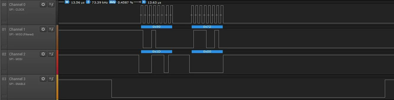

I am new in SPI protocol and trying to perform an application with LORA-Ra02 module via SPI protocol. I can send data through MOSI by considering DataFrame, CPOL, CPHA, rw bit of the frame but I cannot receive any data through MISO. I performed this application with both STM32 and Arduino to compare the differences. I want to share some picture and code to be understood better.
This is the picture of trying with Stm32f103, no incoming data :
This is the picture of trying with arduio, Datas must be like in this picture actually :

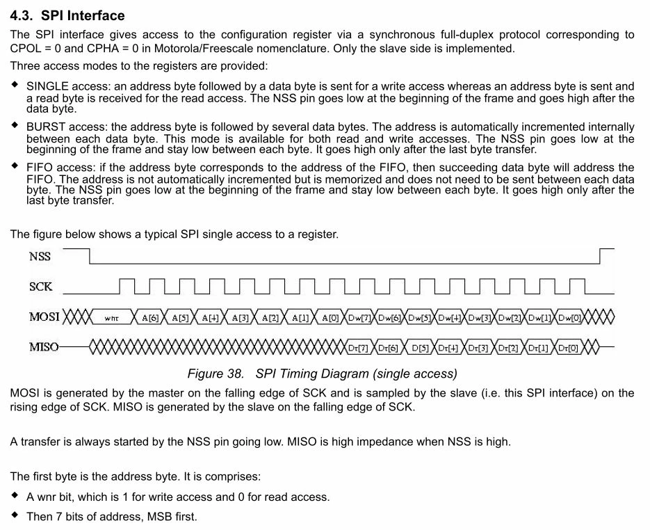

This is the information about SPI protocol of LORA Ra-02 module :

What seems to be my problem ?
Thanks in advance !

    There is no problem with pin connections, I controlled pairs of pins, all is true, I thought that maybe device is broken-down I tried another lora, result was the same, Configurations seem true ; 8 bit, msb first, mode = 0, full duplex etc.
    I never changed spi configuration, considering SPI protocol of LORA as it is seen above, configuration seems true
    In arduino example, They use RESET and DI0 pin on LORA. Do those pins affect SPI communication ?
