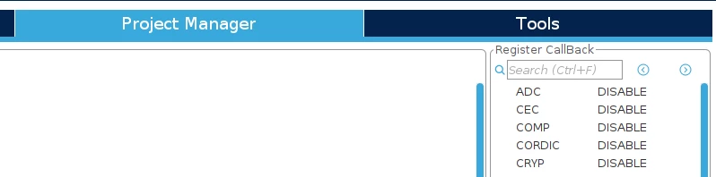

To get the callbacks (+ yes, only for Tx , with circular DMA ) set in Cube : Callback enable I2S ...see:

Thanks a lot, i forgot to register the i2s Callbacks. Since the DMA Callbacks are automatically registered for RxTx, i would't think of registering i2s Callbacks seperately.
