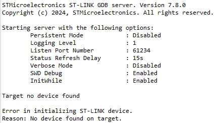

Hi Community,
Prelude: I soldered my first PCB, added STM32H743ZIT6, decoupling capacitors, BOOT0 switch, NRST with resistor to ground, 5V->3.3V LDO, powered up by USB and 4-pins SWD for debug (PA13/DEBUG_JTMS-SWDIO and PA14/DEBUG_JTCK-SWCLK pins). Checked power supply with multi-meter, decoupling capacitance, no short circuits, MCU pins are soldered norm and everything seems ok. I had some problems in process and *maybe* MCU is damaged, but before replace it I would like to ask have I did all right to check MCU with ST-LINK V3 and STM32CubeIDE ?
I would like to mention, that my PC USB ports output only 2.6V, not 5V (ST-LINK runs ok, but maybe this is the reason?)
To connect ST-LINK to SWD I used Bridge connector CN9, choosing IO0 and SCL pins.

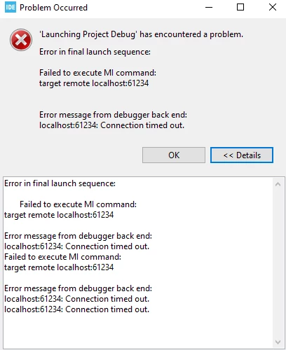

In STM32CubeIDE I tried both GDR Server and OpenOCD with the same result, except OpenOCD mentioned, that 0.0000 voltage is detected (although I checked immediately with meter and voltage exists).
I also has USART interface and USB on board, maybe there is the way to check MCU with them (with or without ST-LINK)?
Thank you for available advice!

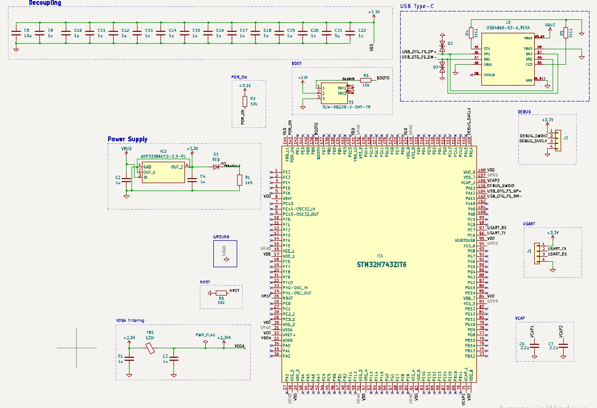

As it is a custom board you need to share your schematics.
Thank you.

Please show the schematic of your PCB, and the full log from STM32CubeIDE.

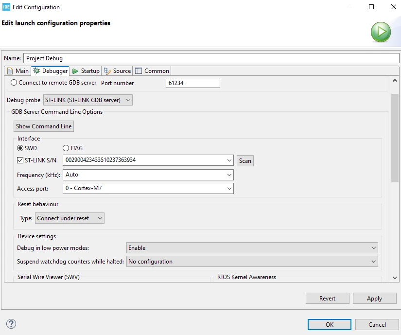

Have you tried with NRST connected to the ST-Link, and using the 'Hardware reset' option for connecting?
It is not available with current design (maybe with some trick if externally connect MCU pin by wire externally.. maybe will try).

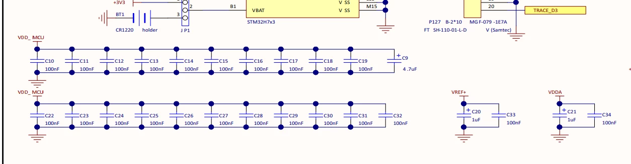

Not sure about the decoupling capacitors value as the screnshot has bad resolution, but the recommanded decoupling capacitors value is 100nF with one 4,7uF in parallel:
From AN4938 "Getting started with STM32H74xI/G and STM32H75xI/G MCU hardware development"
