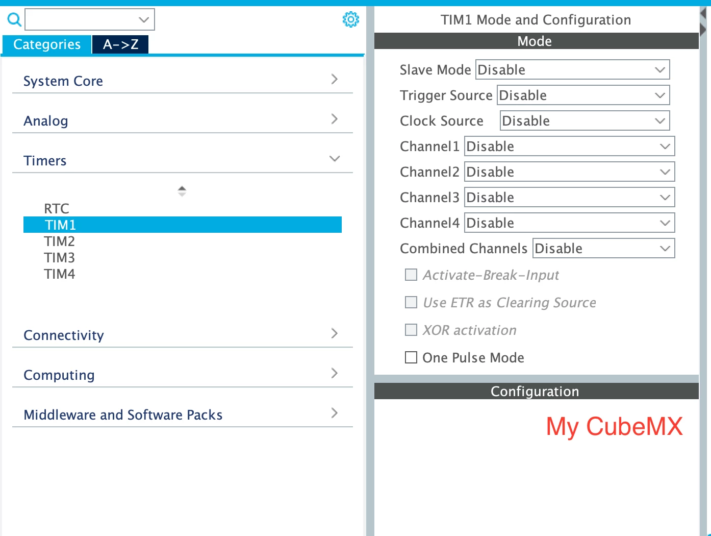

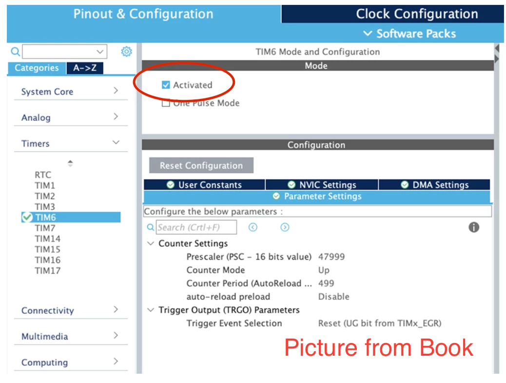

Hello, I am working with "Mastering The STM32" book and faced with one problem: cannot find the option as in the book to activate any timer using CubeMX. I am using STM32 blue pill STM32F103C8T6. Why I can't find the activate option of timers?

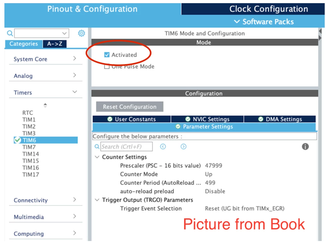

That's for TIM6 - your chip, STM32F103C8T6, does not have a TIM6 !
See datasheet: https://www.st.com/resource/en/datasheet/stm32f103c8.pdf
That image from the book shows the configuration for a Basic Timer: as the name suggests, these have very few configuration options.
But this is the configuration for TIM1:
This is an "Advanced Control" Timer - so has a lot more options than just a simple 'Activate':
