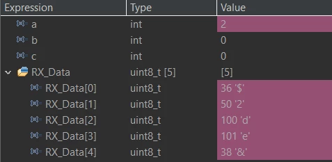

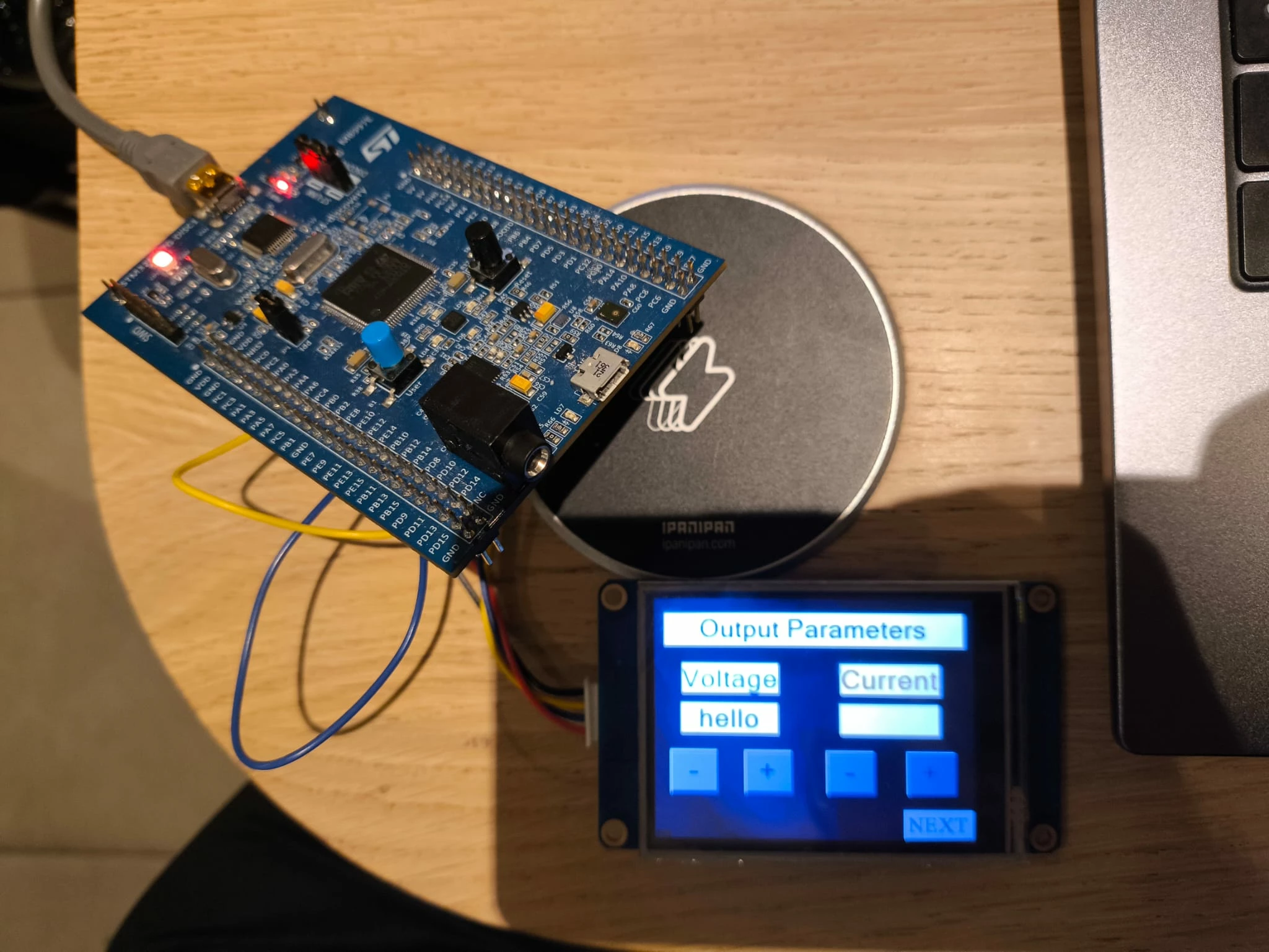

I am using an STM32F407 Evaluation Board in my project, along with a Nextion HMI Display that communicates with the MCU over UART.
In this project, I send data every 1 second using a TIM interrupt with UART Polling Mode, and I receive data from the Nextion HMI using UART in interrupt mode (UART IT).

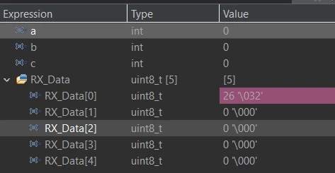

The issue arises when both transmit (TX) and receive (RX) operations happen simultaneously. The reception completes successfully, but the transmitted data from the Nextion HMI behaves incorrectly. However, if I perform only the receive or only the transmit operation, everything works fine.
I suspect that the problem occurs because the transmit and receive operations are colliding or overlapping.
I am attaching screenshots that show how the system should work and the problems I am encountering.
Could you help me identify where I might be making a mistake?
I am also struggling to find a way to transmit data using UART in interrupt mode (UART IT). I could use some help with that part as well.

I figured out the problem. I was trying to send data to other pages while on a specific page. Basically, what happens is that the Nextion HMI gives an error code if I try to send data when I'm not on the correct page. So, I classified the transmitted data according to the page data received. Here is the code that works fine.
