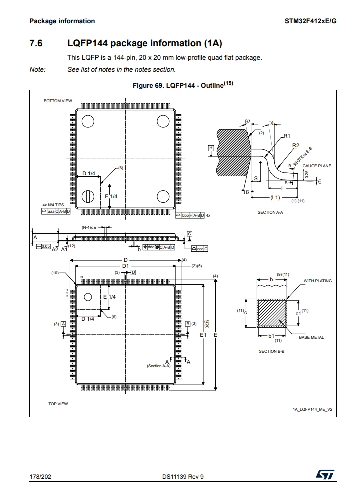

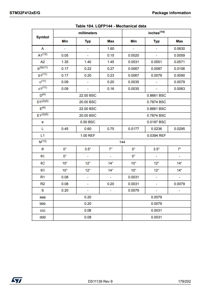

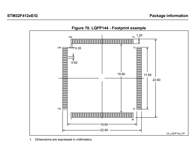

Hello @ivan paul;
Are you looking for LQFP144 package outline and dimensions?
The DS11139 Rev 9 section 7.6 LQFP144 package information (1A) provide LQFP144 mechanical data.
Thank you.

Hi Kaouthar,
Thank you for your reply.
I need the tray package dimensions to ensure the tray fits properly in the pick-and-place machine. What is the feeding direction and pitch dimension?
Could you help me locate the tray drawings for the STM32F412ZGT6 with the 144-LQFP (20x20x1.4 mm) package?
