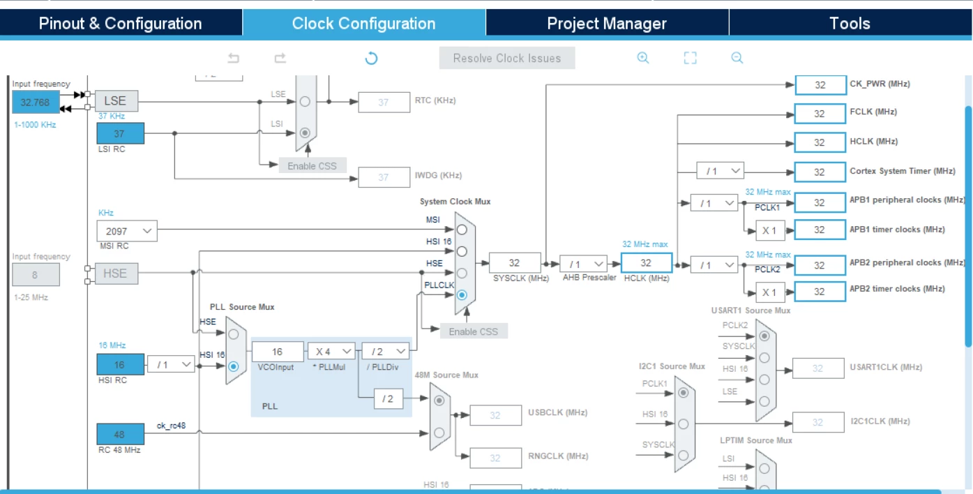

A) you have wrong clock configuration
B) you have wrong timer configuration
Use MCO feature and PLL instead of Timer. It will have better frequency resolution.
Feb 28, 2024 3:20 AM UTC
Hi , Please find below the clock configuration , I have used TIM2_CH1 for generating PWM signal @ PA0 pin. All timers are configured to 32 MHz only, In my clock configuration , the MCO source is not selectable ( greyed out). And the below code is what I used for the same. Please guide me  how to get the desired frequency of PWM signal( atleast 16 MHz) . FYI, I am using STM32 L073RZ board.
The value of htim2.Init.Period was changed many times and at max I have got only 580 Khz signal by setting this value as "55-1".

Feb 28, 2024 5:44 AM UTC
Search tutorials to use MCO ... for example:
https://community.st.com/t5/missing-articles/how-can-i-output-a-clock-signal-to-the-stm32-s-mco-pin/td-p/49583
If your timer "period" is set to 55, then its frequency will be 32MHz/55=582kHz... what is wrong with that ? :)
