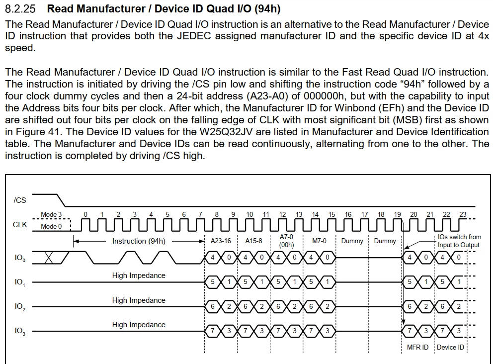

Need to accurately read Manufacturer/Device ID using QuadSPI from a W25Q32JV (Winbond Flash).
I understand need to send Instruction 0x90, followed by 3 dummy bytes 0x00 to external flash. The rest configuration is OK. The code is as following.

and the following function is used to read ID from Flash. The Manufacturing ID is of 1 byte and Device ID is of 2 bytes. So the length is 3. Address is 0x00. how to send 3 dummy bytes (0x00). Shall I edit dummy cycles for it?

PROBLEM SOLVED!
Current settings for SPI QUAD I/O.
 /* Reading Sequence*/
sCommand.Instruction = 0x94;
sCommand.AddressMode = QSPI_ADDRESS_4_LINES;
sCommand.Address   = address;//0x000000
sCommand.NbData   = length;
sCommand.DataMode  = QSPI_DATA_4_LINES;
sCommand.DummyCycles = 4;

From the data sheet, the command 0x90 uses one output line. So,
 sCommand.DataMode  = QSPI_DATA_1_LINE;
