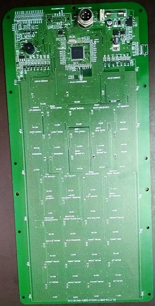

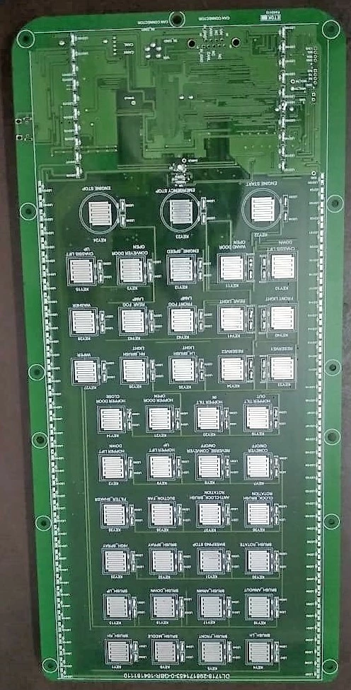

As discussed in my earlier post we have developed 44 Keys capacitive touch key pad with 4 layer PCB board in Matrix touch scheme between two touch TSC groups with Layer 1= top Digital track, Layer 2= shield and touch track, Layer 3= shield and Layer 4 = touch and digital track, based on STM32L452VET6 100 Pin LQFP package using TSC Peripheral and STM touch middle ware.
Although we are using these Touch IPs very frequently and successfully in Non Matrix touch scheme but this is first we have used it in this format to meet the customer requirement for 44 Nos of keys. I have attached Picture of top and bottom of the PCB for your kind reference.
We are facing calibration issues as keys are non sensitive when applied overlay of 1mm of acrylic. We have applied capacitors of upto 68nf but there is no change in the delta and no touch detected.

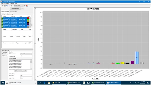

But without overlay there is the touch detection but poor calibration and response below is the screen shot for the same.
  1. Screenshot of STM Studio for both cases
           When in Ideal State
0690X0000060C8LQAU.pngWhen a key is pressed without overlay
0690X0000060C8bQAE.pngKindly advice how to calibrate it by increasing touch sensitivity.

    First, I would like to know if you have already reviewed the application note
    https://www.st.com/content/ccc/resource/technical/document/application_note/19/12/dd/6b/8e/d2/49/fb/CD00276277.pdf/files/CD00276277.pdf/jcr:content/translations/en.CD00276277.pdf
    : Guidelines to increase the number of touch sensing touchkeys?
    When using matrix, please note that:
    • Touching one touchkey may induce sufficient capacitance change on other channels
    • Special care must be taken to avoid
      • Imbalanced electrodes
      • Columns and lines electrodes tracks too close in the user touchable area
    It is recommended to have homogenous sized touchkeys so that each touchkey has the same sensitivity.
    This simplifies the threshold setup and acquisition can be achieved using the same sampling capacitor value.
    In all cases, you have to pay attention to &39ghost effect&39 as described in the application note.
    Then, in order to increase touch sensitivity, please take into consideration the following:
    • Reduce air-gapâ€� between pcb and overlay
    • Decrease Rs (Sensor serial resistor)
    • Increase CTH and CTL values
      • htsc.Init.CTPulseHighLength = TSC_CTPH_16CYCLES
      • htsc.Init.CTPulseLowLength = TSC_CTPL_16CYCLES
    • Set Max Count value to 16383
      • htsc.Init.MaxCountValue = TSC_MCV_16383
    • Increase HCLK and set PulseGenerator Prescaler to 1 or 2:
      • htsc.Init.PulseGeneratorPrescaler = TSC_PG_PRESC_DIV1
    I hope this bring you some help.

    I have not made a touch board before, but Ive been working on one last week.
    there should be no surface mount parts on the touch side, to reduce air spaces
    I think this is your answer:
      Reduce air-gapâ€� between pcb and overlay   thanks
    st.mcu
    can you pour some thin goop between the PCB and the 1mm of acrylic ?. and be sure to remove all air bubbles
    this will remove all airspaces and increase the sensing range.
    It may actually work better with a thicker acrylic/goop.
