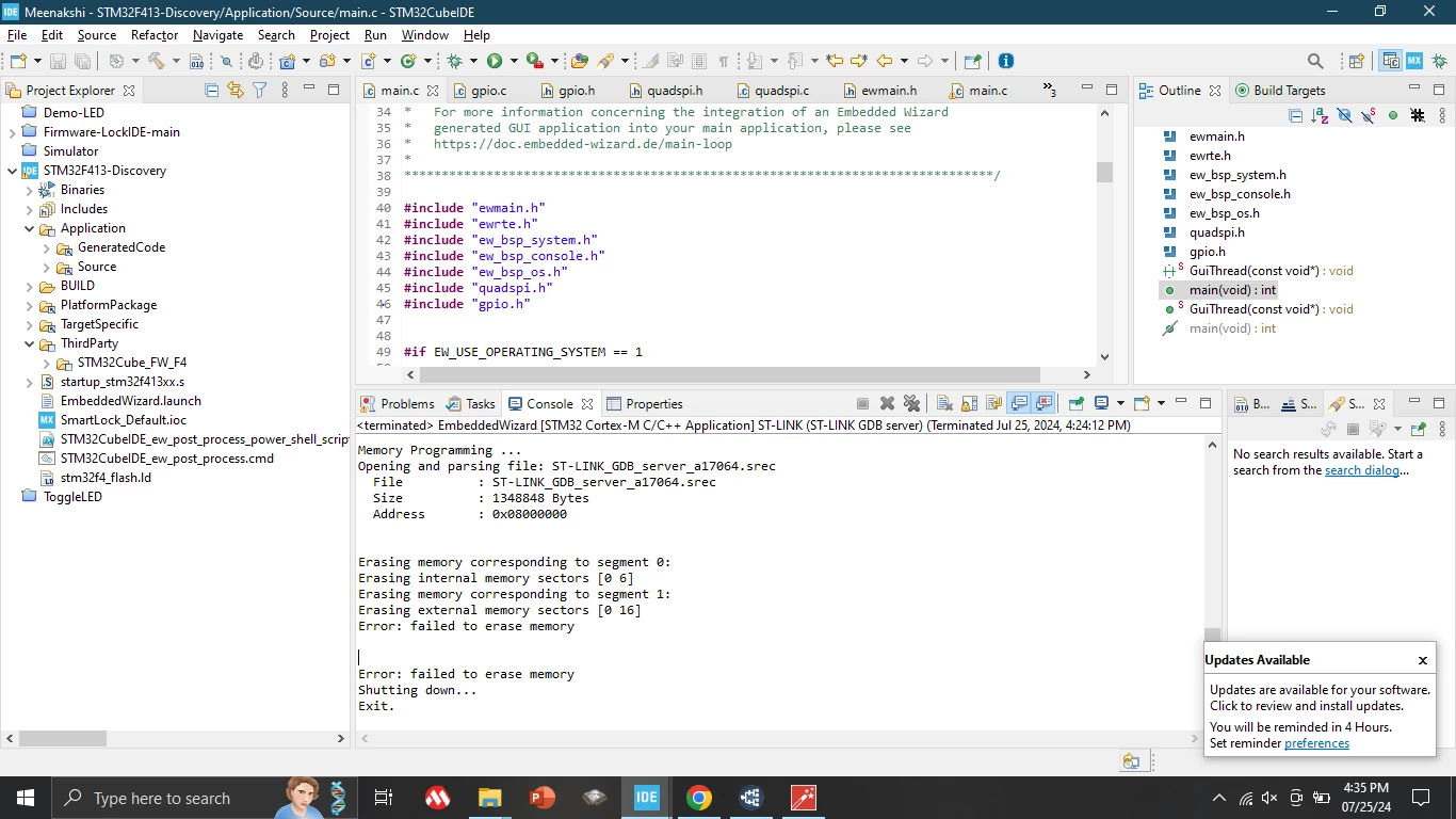

I'm creating a project on GUI using an embedded wizard. While I'm trying to flash the code to my STM32F423ZHT6 custom board. It shows an error: failed to erase memory.
I'm using STM32CubeProgrammer and I successfully erased the entire flash. But still it shows the same error. I'm using GD25S512MDYIGR QSPI Flash memory. So I need a suitable flash loader for the STM32CubeProgrammer.

I can probably construct one, but would need the pin designations for the QSPI interface you have built.
https://github.com/cturvey/stm32extldr/blob/main/README.md
GD25S512MD
