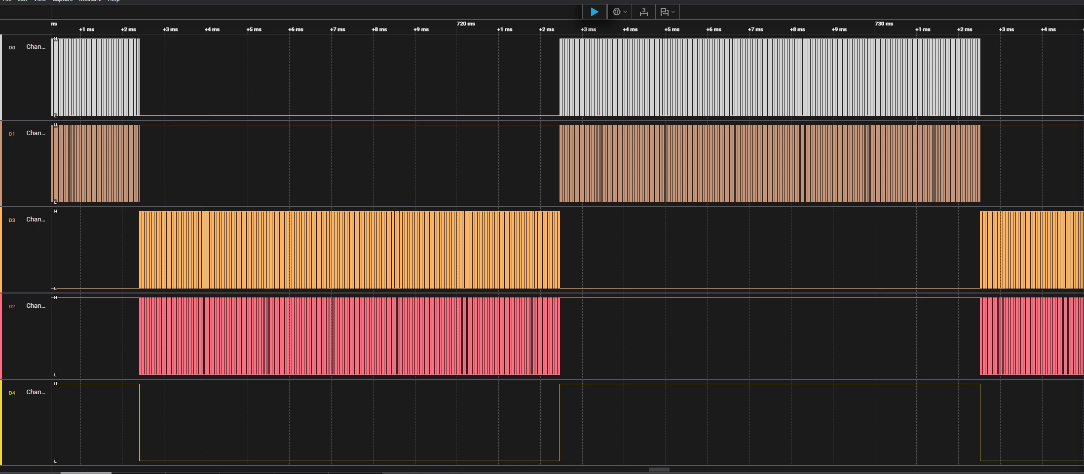

I have a digital power converter topology (H-bridge) which requires waveform to look like the following:
As can be seen in the above, complementary waveform is being sent on bottom 2 channel in 1st 10ms and then they are being in the IDLE state while complementary waveform is being sent on other 2 channels in next 10ms.
I have achieved above using HRTIM (TIMERA and TIMERB) and TIM17.

I would rather prefer to have hardware to generate the above waveform without CPU intervention. However, I have not been able to find any useful feature which would help me generate the above waveform (Closest is Burst Mode in HRTIM, but it applies burst to all the channel equally, which is not what I want). And this is where I need help!

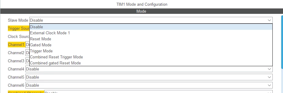

Hello TDK
do u mean to use TIM1 in gated mode?
May 31, 2025
You need multiple timers. Look at "Slave mode: Gated mode" in the reference manual.
Say TIM1 is the master, set TRGO and TRGO2 to drive TIM2 and TIM3 which generate the smaller pulses.
