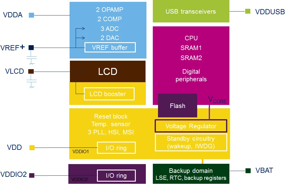

Hi, recently in a project I need the GPIOs on STM32 to operate on 1.8v logic level. By quickly looking through datasheets, it seems many of STM32 can do so, for example, to STM32F407VG, if provide 1.8v to VDD, it runs GPIO on 1.8v level. However, I have difficulty to make such changes on TM32F4Discovery board, as there is no 1.8v power source available on the board.
Now I have the question, which ST Discovery board or Nucleo board can support &sharp1.8v GPIO easily? I want to try it out. I need the board support USB port as USB device, and run the GPIO on 1.8v, it would be better if it provides I2C slave interface on 1.8v also.

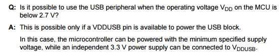

    Hello Jismal Jamal,
    Thank you for designing with STM32L4 MCU. If you want to use USB, then you need to keep VDDUSB on at least 2.7V, while rest of VDD pins can be supplied with lower voltage, for example 1.8V, which you mentioned.
    Statement, which confirms this can be found is ST documentation: application not
    http://www.st.com/content/ccc/resource/technical/document/application_note/group0/0b/10/63/76/87/7a/47/4b/DM00296349/files/DM00296349.pdf/jcr:content/translations/en.DM00296349.pdf
    . Please see the extract below:0690X0000060Kn5QAE.png

    USB won't work from a 1.8V supply. You'd need an L series part with a VDDUSB pin to power the transceiver.
    When interfacing to 1.8V modules with the F2/F4 we use level translators, some TI part with 8 bidirectional channels as I recall.

    it seems to me that maybe STM32L4 can be an interesting solution for you. STM32L4 in packages with big amount of pins (LQFP144, BGA132, CSP72 and CSP81) have VDDIO2 domain. This domain has a dedicated supply pin, which level can be in range of 1.08 ? 3.6V, comparing to VDD 1.71 ? 3.6V and VDDUSB 3 - 3.6V. VDDIO2 domain supplies only pins from GPOIOG, while VDD supplies rest of the GPIOs. With this solution you can easily get a voltage level tranlator or pins operating on different voltage levels.
    Regarding the evaluation boards with STM32L4: you can use
    http://www.st.com/content/st_com/en/products/evaluation-tools/product-evaluation-tools/mcu-eval-tools/stm32-mcu-eval-tools/stm32-mcu-nucleo/nucleo-l496zg.html
    , as it offers STM32L496 in LQFP144 package. Unfortuantely VDDIO2 on this board is connected to VDD, so you would need to cut a wire and make hardawre modification on your own.

    Start from looking at the STM32L4 family. It has separated USB, VDDIO1 and VDDIO2 supplies which would enable a rich mix of diverse supply voltages to coexist. For each group of GPIO supply voltage there are the usual serial interfaces suspects. This way, external voltage shifters might be avoided.
