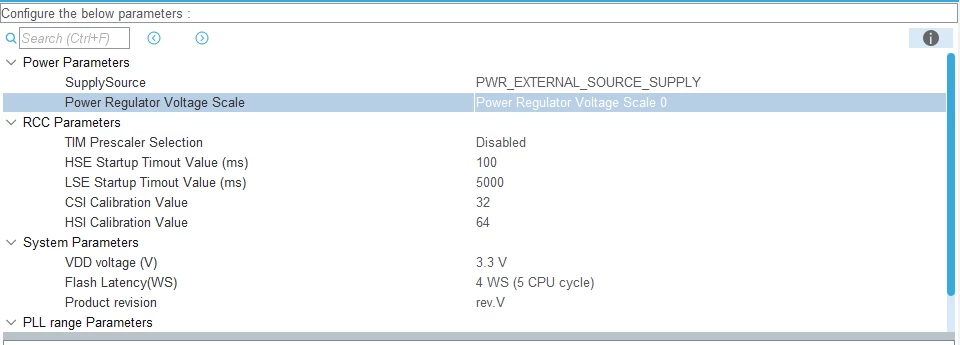

need help with STM32H750VB Power regulator voltage scale
hi i have a problem where i want to get the stm to 480Mhz clock but in order to do that i have to set the Power regulator voltage scale to 0
0693W00000Y8LBgQAN.pngbut when i do this the micro controller bugs and i cant connect to it the programmer just say no stm32 found how can i increase the frequency ? i have my custom board i'll share anything if needed

Hello @bakhti​,
The VSO0 is available only when the LDO regulator is ON.
So, to get 480 MHz, please go to the RCC parameters and modify the SupplySource "PWR_LDO_SUPPLY".
For more details please refer to the DS12556.

Can you explain how this relates to packages (such as the LQFP100) which do not have a VDDLDO pin? Can the LDO still be turned on? And if so, what does it do, and what effect should it have at slower clock speeds?
emagn
October 12, 2023
When it is not available on a package, the VDDLDO pin is internally tied to VDD
