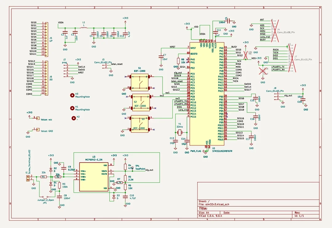

I am trying to build a STM32L0 based low powered project , i am hitting target hold under reset randomly and when i left it power off for few hours its back to working . idk why its happening randomly
3 replies
vedantggAuthor
September 12, 2026

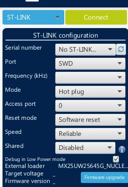

AScha.3
September 12, 2026
What program to connect ?
Which st-link ? genuine ?
try with CubeProgrammer , mode : soft.reset, hot plug

Thanks for the comment  , but i fix the issue by shorting nrst to vcc with 10k resistor
