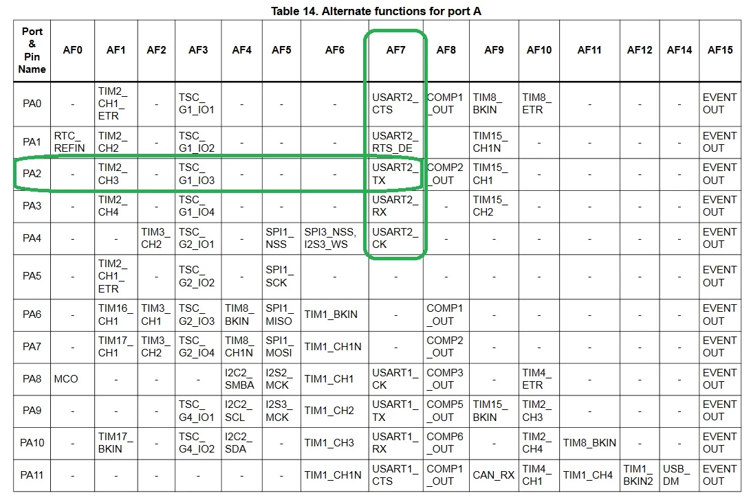

Need help using USUART2 on STM32F303
Posted on February 16, 2018 at 22:30
I'm trying to find instruction to code the usuart2 on this STM part. I using cmsis and the StdPeripheral lib. My end goal is to connect this to a virtual com port for debug. I'm using the Keil development environment.
I using the default HSI clock setup running at 8MHZ then -
RCC->AHBENR |= BIT17; //Enable portA clock
RCC->AHBENR |= BIT18; //Enable portB clock
GPIO_InitStructure.GPIO_Mode = GPIO_Mode_AF;
GPIO_InitStructure.GPIO_PuPd = GPIO_PuPd_NOPULL;
GPIO_InitStructure.GPIO_Pin = GPIO_Pin_2;
GPIO_Init(GPIOA, &GPIO_InitStructure);
RCC_APB1PeriphClockCmd(RCC_APB1Periph_USART2, ENABLE);
USART_InitTypeDef USART_InitStructure;
USART_InitStructure.USART_BaudRate = 115200;
USART_InitStructure.USART_WordLength = USART_WordLength_8b;
USART_InitStructure.USART_StopBits = USART_StopBits_1;
USART_InitStructure.USART_Parity = USART_Parity_No;
USART_InitStructure.USART_HardwareFlowControl = USART_HardwareFlowControl_None;
USART_InitStructure.USART_Mode = USART_Mode_Rx | USART_Mode_Tx;
USART_Init(USART2, &USART_InitStructure);
//send the data
USART_SendData(USART2, 0xaa);
I realize the baud may be wrong but right now I'm trying to see something on the PA2 pin
with a scope. Nothing is changing.
I tried to make sure the tx register was empty before writing the data using:
if( ((USART2->ISR) & BIT7)) != 0) {
Still nothing coming out.
Any suggestions.

    Tesla DeLorean
    Tesla DeLoreanBest answer
    Guru
    Feb 16, 2018 11:34 PM UTC
    Posted on February 16, 2018 at 23:34
    Data Sheet, Table 14
    http://www.st.com/content/ccc/resource/technical/document/datasheet/f2/1f/e1/41/ef/59/4d/50/DM00058181.pdf/files/DM00058181.pdf/jcr:content/translations/en.DM00058181.pdf

    Tesla DeLorean
    Guru
    Feb 16, 2018 11:16 PM UTC
    Posted on February 16, 2018 at 23:16
    Also needs mapping through the mux
    /* Connect PA2 to USART2_Tx */
    GPIO_PinAFConfig(GPIOA, GPIO_PinSource2, GPIO_AF_7); // USART2 MUX AF7

    Randy Nelson
    Feb 20, 2018 8:06 PM UTC
    Posted on February 20, 2018 at 20:06
    Andrew,
    I was referencing both the reference manual, RM3016, the programming manual, PM0214,  and the STM32F303x6/x8 doc. I DID miss the RM316 section 11.3.2 dealing with the AF register. Reading this section and using Clives table would have help me resolve my own problem.Thanks for everyone's help.
