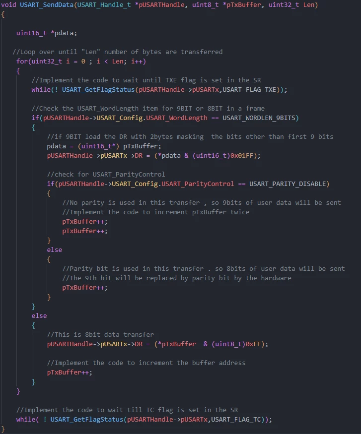

this is code from an Udemy tutorial but i couldn't get the part of 9 bit data transfer with no parity bit can anyone help me to understand that please

What part is tripping you up?
With 9 bit no parity, it uses (reads and advances) 2 bytes of the buffer per character.

October 16, 2023
suppose my data is uint8_t data[5]={0xFF, 0xFF, 0xFF, 0xFF, 0xFF} now the len of my data is 5 so it will be pass as len. Now my loop will iterate 5 times if i am not wrong but the problem is when we cast it into uint16_t *pdata it will take first two item as one now then it will be mask as 9 bits and pTxBuffer will be increment twice and point to next 16 bit. now my confusion is withing 3 iteration my data array will be completed and if we take 0xFFFF and mask it
then the data become 0x1FF how they can be same
This data is not 9-bit data.
9-bit data would be stored as an array of uint16_t values.

October 16, 2023
but what is saw in my pc if i cast 8bit array into 16 bit then it became from uint8_t data[5]={0xFF, 0xFF, 0xFF, 0xFF, 0xFF} to {0xFFFF, 0xFFFF, 0x00FF}

True but irrelevant. The issue comes from you using a uint8_t array of length 5 to pass 5 parameters of 2 bytes each. Clearly 5 != 10 so, as you mentioned in your previous post, the function will read outside of the bounds of the array.
So fix the problem: declare the array as uint16_t.

October 16, 2023
Then find a tutor or teacher that you're paying. Perhaps find someone who can cover pointers, and data representation in memory
Do you want to send as 9-bit? If so that data has to come from somewhere.
You can't randomly cast a structure, and change it's content. You're just telling the compiler to process the data in memory a different way. The bytes in memory don't change, the size of the structure in bytes doesn't change.
Where the peripheral is adding the parity bit, it takes 8-bits from you and adds it into the 9-bit shift register. If you want to send 9-bits of actual data, it needs to read at least that much from memory, it reads 16-bits as that's the next size up sufficient to do that.
You could send an array of uint16_t
uint16_t data[5]={0x1FF, 0x1FF, 0x1FF, 0x1FF, 0x1FF}

ST uses casting as it's C, and they only want to implement one universal function.
Most people aren't using 9-bit mode, and those using parity its somewhat invisible.
9-bit mode is most often used where you're trying to differentiate data from a command/control channel. ie the additional bit flags as to whether the byte should be processed as data, or handled specially as a command. Sometimes used on 8051 in multi-processor mode, a special byte in the stream indicates the MCU you wish to address, whilst the other bytes you want the MCU to consume into it's buffers. ie a very simplistic networking protocol, where there's a constant stream of data, and you want ONE to cherry pick specific blocks of bytes.
If you're not using 9-bit data forms, perhaps stop getting hung up on this, and come back to it when the need or reasoning becomes more apparent. Perhaps look at more examples of pointers and casting, and why they might be useful.
