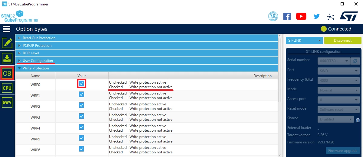

Hi @RBharol​
I suspect the write protection is active. You can use STM32Cube Programmer to check the flash memory sector and disable the write protection as shown in the attached figure.
Also, for more details about option bytes and write protection you can refer to STM32F4 reference manual, section "3.4 Flash option bytes" with focus on "3.4.4 Write protections".
