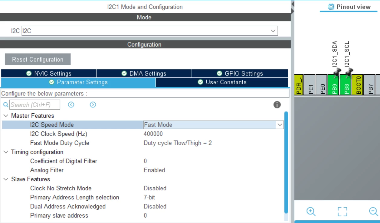

First of all you need to set the configuration of the I2C for the communication based on STM32CubeMX :
  • You can choose the Standard mode 100 KHz or the Fast mode 400 KHz.

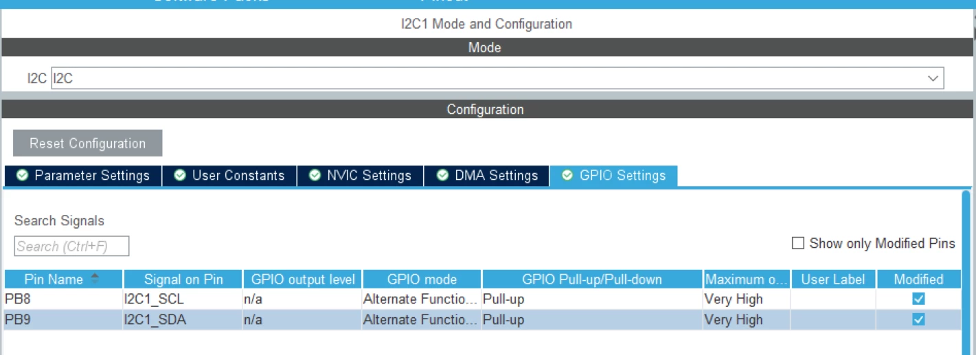

  • Set the GPIO at the PULL-UP :
0693W00000WLAyGQAX.pngThen generate The code.
The I2C address of the sensor : 0x18
Supply voltage : 1.6V - 3V6
Connect the  3V3, GND, SCL, SDA.
Foued.
