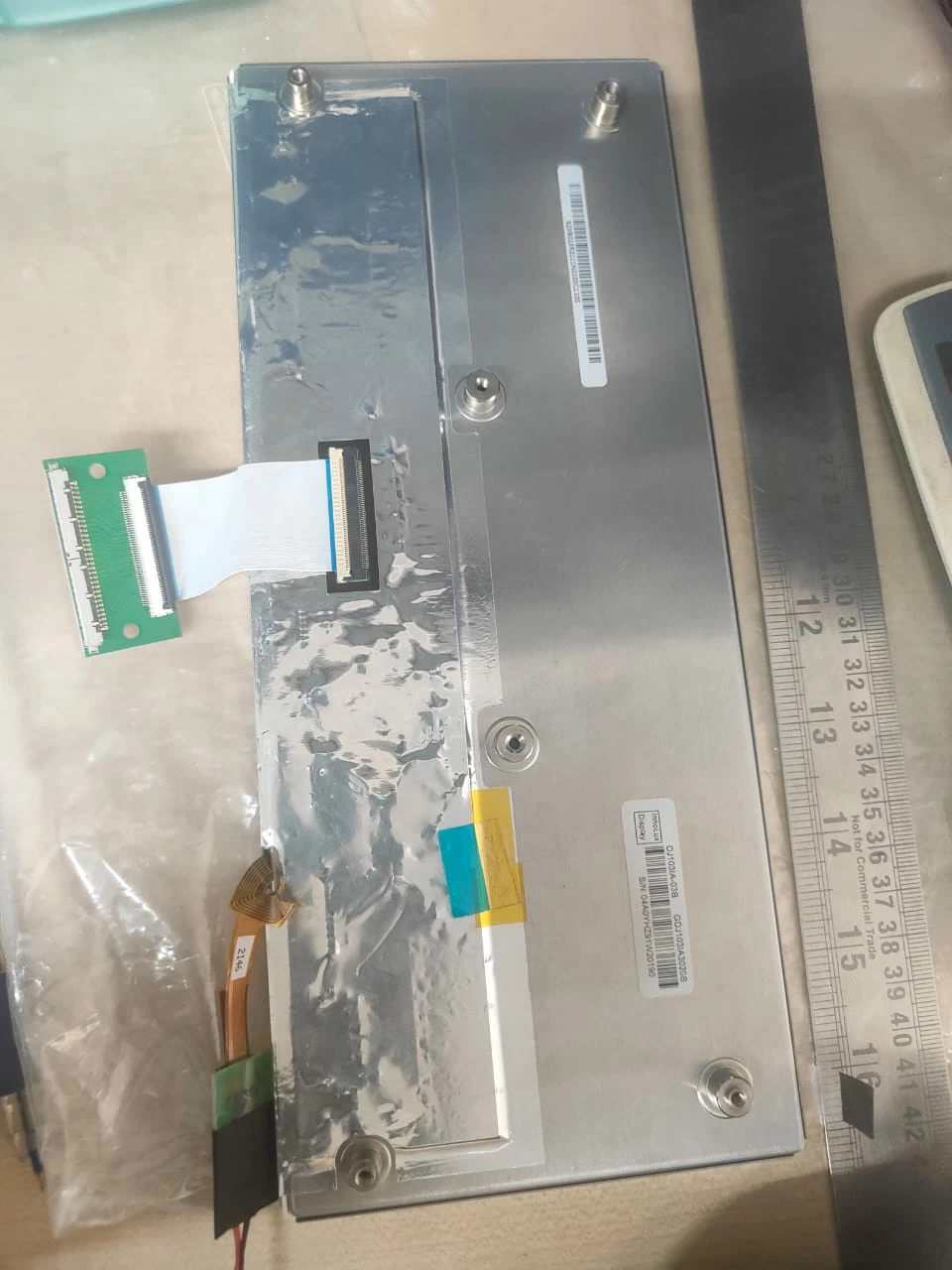

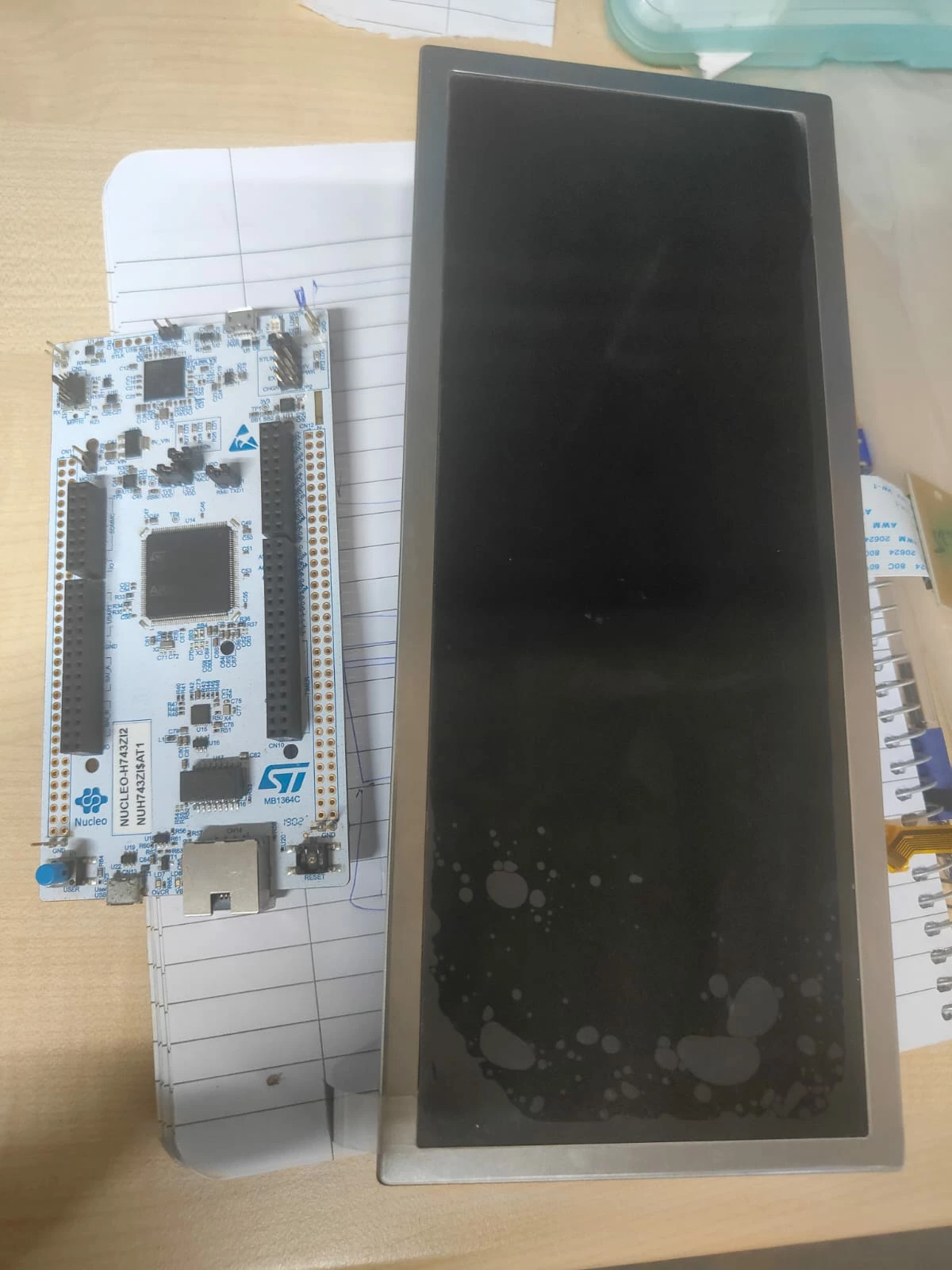

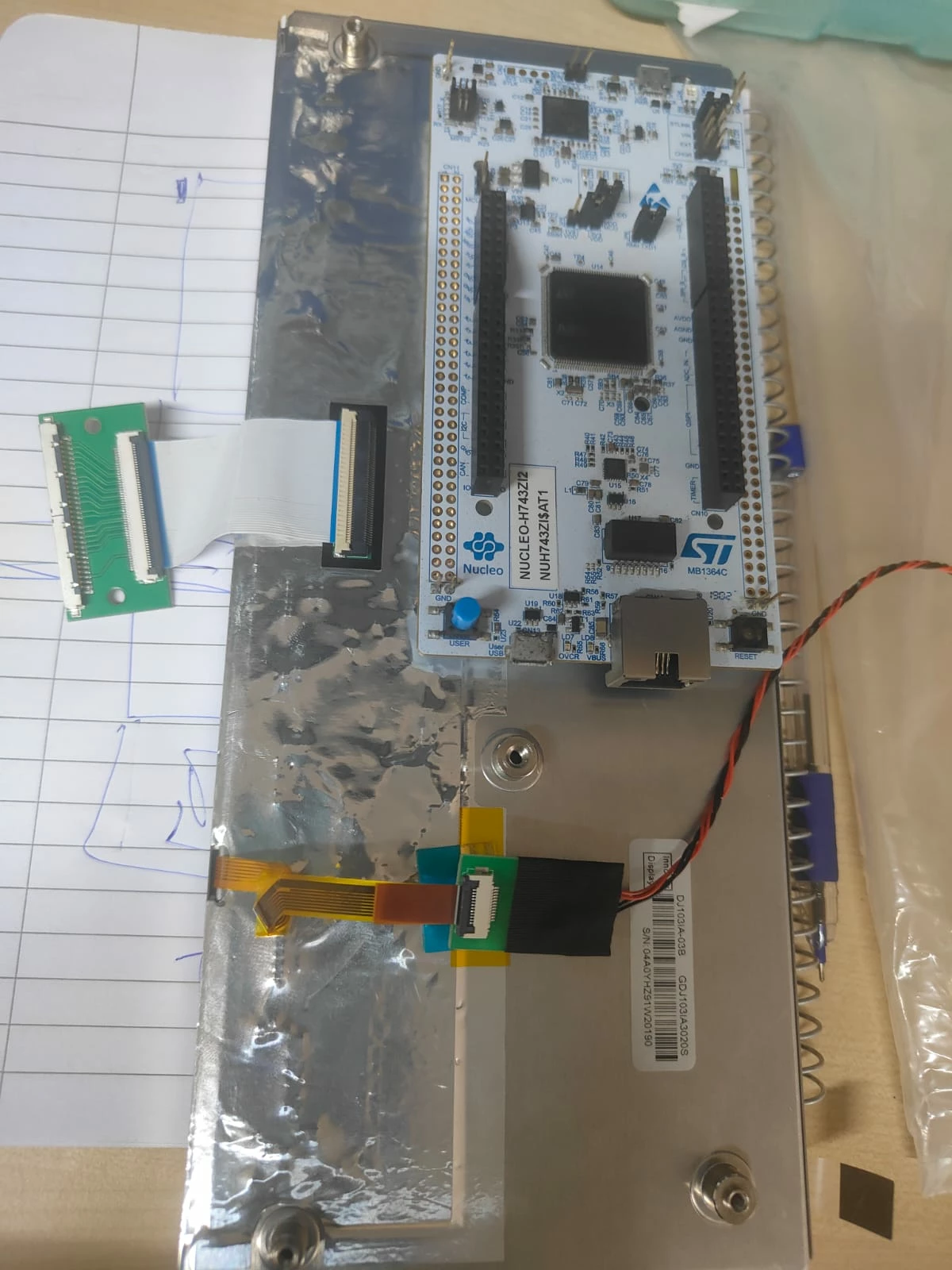

I apologize for the multiple inquiries but appreciate your consistent support. presently, we got clear vision from our boss who is not technical person. So, only i'm struggling slightly. On developing an ECG machine similar to the Mortara ELI 280, rather than a full patient monitor. At this stage, we need to interface a display with the STM32F769-DISCO and Nucleo H743ZI boards.
We have a specific requirement to integrate a 10.1-inch IVDS display with a resolution of 1920x720. Could you advise on the best method for this? Is it feasible to convert the MIPI DSI output of the STM32F769 to LVDS, or should we design a small PCB for interfacing LVDS with the STM32F769, guided by the datasheet?
We currently have the Innolux DJ103IA-03B display with a 50-pin connector available for this project, so we need to find a compatible interfacing solution.
