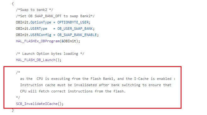

mƎALLEm
June 20, 2024
To my opinion, you need to invalidate the ICache before jumping so the CPU will fetch correct instructions from the flash using SCB_InvalidateICache().
See for example FLASH_SwapBank: https://github.com/STMicroelectronics/STM32CubeH7/tree/master/Projects/STM32H743I-EVAL/Examples/FLASH/FLASH_SwapBank
The example invalidates the I cache before executing from the new Bank.

mƎALLEm
June 20, 2024
What if you disable the cache while Handling the Flash (erase/program) and enable it in the application that you would jump to it? (inspired from the example in STM32CubeH7: Projects\STM32H743I-EVAL\Applications\ExtMem_CodeExecution\ExtMem_Boot)
Are you also enabling the cache in the application that you want to jump to?
