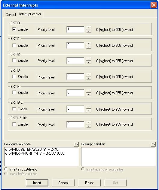

    Hello Ann
    We use Wizards for these configuration things.
    In the image below you can see the NVIC code for EXTI0.  To start with you only need the first line.  You can set the priorty later when you know what you want it to be.
    This is for the STM32F103.
    Best regards
    Crossware
    http://www.crossware.com/
