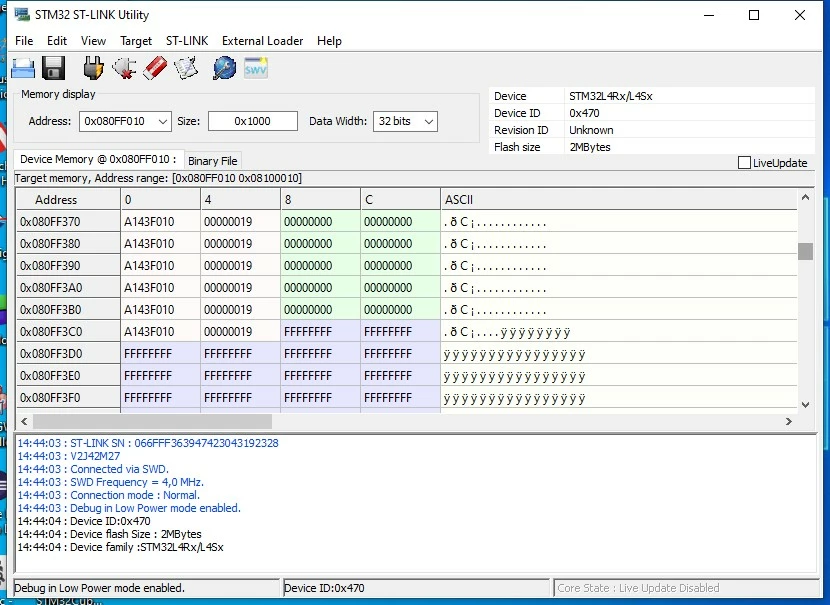

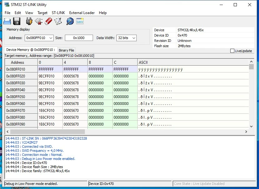

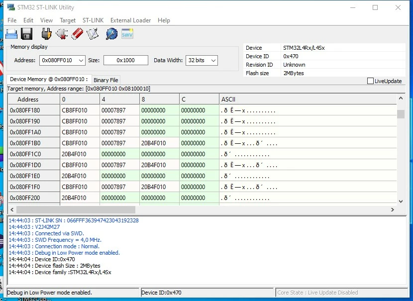

Hello ST community,
I am working with STM32L4R5ZI-P, I am to write data to EEPROM, starting address fro EEPROM _emulation mentioned as 0x080FF000 ,so I took 0x080FF010,here data writing to next location I will provide the snap of that for your reference,eeprom-0.jpg
In the above data is updating in 0x080FF020 location may i know why it is happening.
In the next in the 0th position it writing with some values ,may i know what are those values?eeprom-2.jpgeeprom_1.jpg
I am writing different data like 0x00007897 like this, after that it has some values like 20B4F010 what is this?
Thank you

Looks like a shifted / encoded value.
You have all the source code, perhaps you could walk that to understand the mechanics if that's important to you?
October 19, 2023
Thanks for the response,
I was curious to know why it is happening so I posted here.
Tesla DeLorean
Guru
October 19, 2023
The EEPROM Emulation is designed to journal content over multiple sectors/pages, so it can recover the last written values, and manage erase. It has to cover a lot of potential use cases.
If you can better understand what it is you need to store you can likely tailor a much narrower solution that is more efficient and robust.
EEPROM Emulation is a bit of a hack, in most cases the design needs refactoring properly to use OTP, FLASH, NVRAM, and RAM appropriately, depending on the data, and how/if it changes over time.
