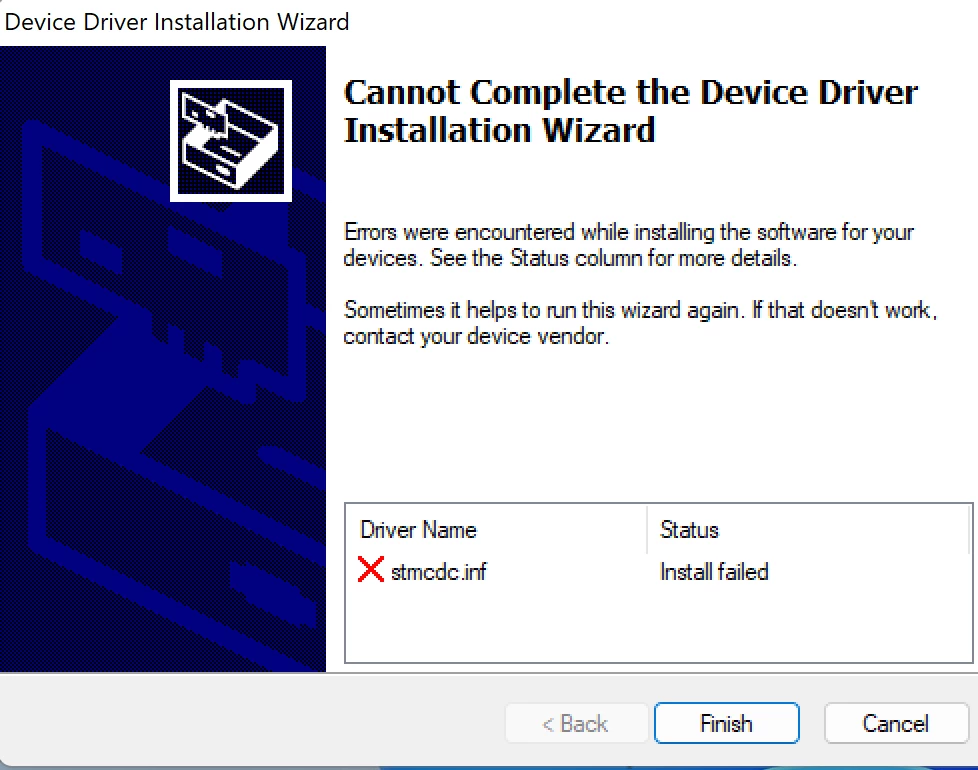

Hi I am new here. I am looking for a driver for Windows 11 Arm (parallels M1).
The chip on my board says STM32F105. The driver that worked for me last time on other Windows was:  dpinst_amd64
Can someone advise a driver for Windows 11 Arm (running Parallels Desktop on M1) Thanks

a) That's not a driver, but an installer
b) You have some third party CAN adapter using an STM32F105, ST didn't write the firmware the vendor put on there, you'll need to track down the vendor and the drivers they furnish for their USB-to-CAN adapter.

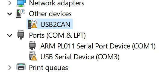

https://github.com/STMicroelectronics/STM32CubeF1/tree/master/Projects/STM3210C_EVAL/Applications/USB_Device
A CDC would come up as a serial port, likely usable with USBSER.SYS, in years before you could munge the .INF files to associate the VID/PID with the USB Device
https://github.com/cturvey/RandomNinjaChef/blob/main/arduino_mbed_rp2040.inf
A MSC should come up as a Flash Stick
How CAN would work/manifest is anyone's guess, it's not a protocol/class inherently supported by Windows/Microsoft. The "firmware" would need to forward or translate USB traffic (URB) into CAN interactions.
How would this work on say a X86 Windows or Linux box?

OK, I give up. Unfortunately I am not an IT guru. I need only this to be installed:
Thanks for the information above, but I am really can't understand it

Is it this "starter kit"?  https://www.farnell.com/datasheets/2308485.pdf
The "USB serial device (COM3)" can be usbser.sys, not sure what is the "USB2CAN".
Using a normal Intel/AMD PC is the best, simple, cheap way to deal with this device. A custom Windows driver is possible but a Windows laptop may cost you less.
