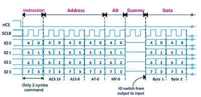

The memory is supported if the command format is in line with the OCTOSPI controller frame format (AN5050):

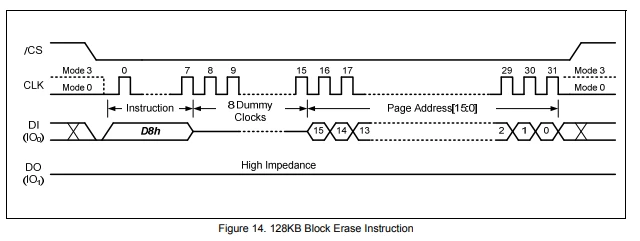

But, according to the memory datasheet, Block Erase (D8h) command needs the address after the dummy bytes.
Thank you.

Thank you for your answer. I know that it is necessary to send an 8-bit dummy after the SECTOR ERASE command. You can see this if you look at the end of the tables. I think the source of the problem I am experiencing is different.
3. Sector Erase:
a. WRITE W25XXX_OP_BLOCK_ERASE (BLOCK ERASE 0xD8 = 0x0000 )
WRITE
DUMMY
READ
0xD8,0x00,0x00,0x00
1 BYTES

To clarify my last comment, the microcontroller sends the OCTOSPI command fields in the following order:
  1. Instruction
  2. Address
  3. Alternate bytes
  4. Dummy
  5. Data
But, the erase command needs the address after the dummy bytes, not before. This command does not follow the order supported by OCTOSPI controller frame format.
Please take a look to this discussion
Thank you.
Kaouthar

Thanks again. I know that. Erase sector sequence is COMMAND+DUMMY BYTES+ADDRESS. But order is not important for my example. My Address= 0x0000 and I write dummy bytes as 0x00. My output data is 0xD8,0x00,0x00,0x00.
