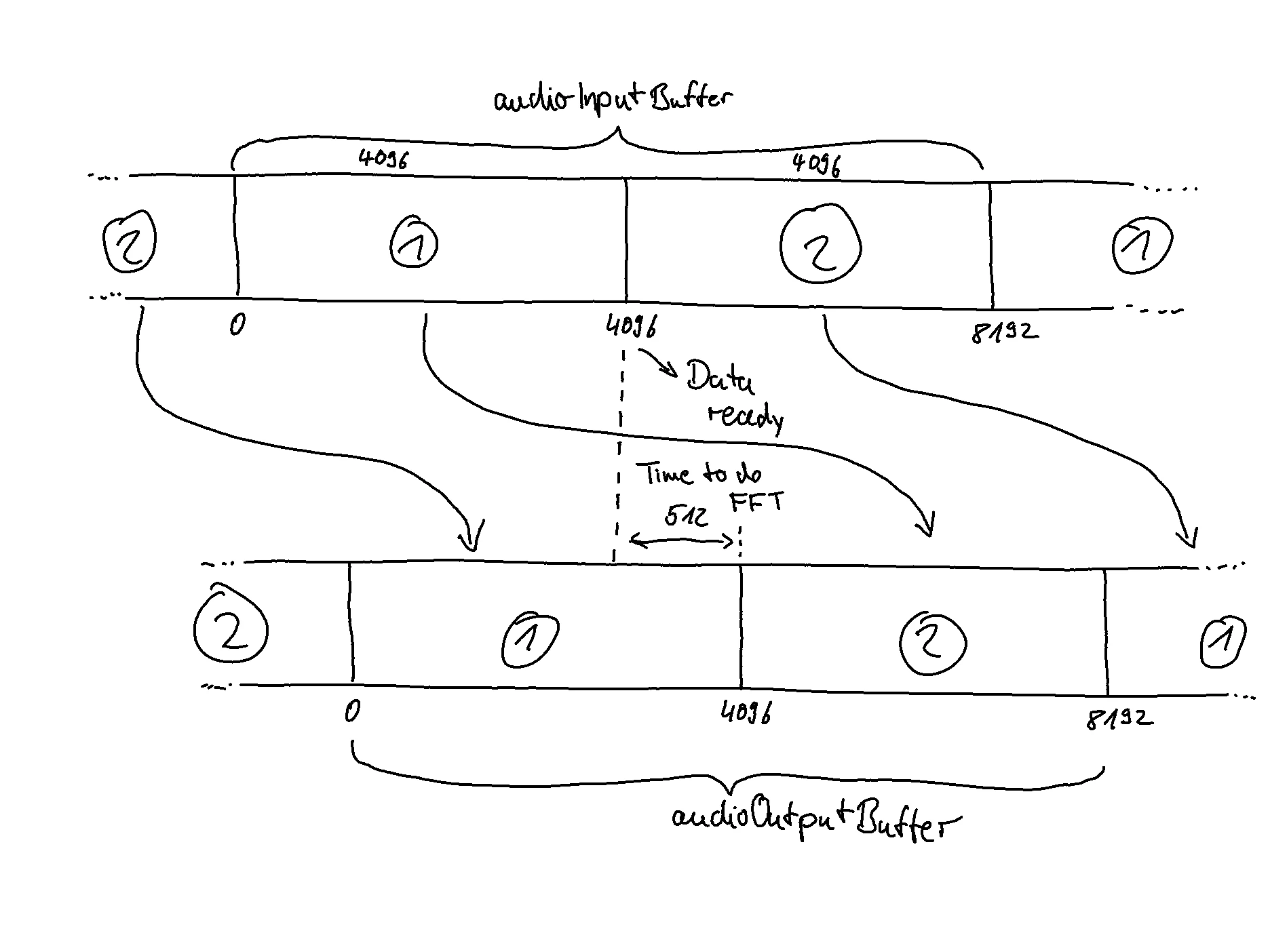

I am currently developing a DSP application on an STM32F439ZI Nucleo board in combination with a Pmod I2S2 audio codec board. So far, basic testing and filtering worked fine until I started to try FFT processing. I isolated the issue in a simple test program (code attached). I am using the CMSIS DSP library for the FFT and IFFT.
This is what the code does:
Audio sample data is transferred over I2S using DMA in circular mode. The DMA buffer itself is rather small in order to have the TxRxHalfComplete and TxRxComplete ISR called every time after one audio sample from the left and right channel has been received. I need this because I have an FIR filter function that needs to be called for every sample transmitted and received (tested and works, but not used inside the test program). Inside the ISRs the incoming samples are converted from 24 bit signed PCM into float32 and copied into a bigger circular input buffer. As soon as one half of the buffer is filled with data a flag is set. Inside the main while loop the sample block is then transformed into the frequency domain using arm_rfft_fast_f32 and immediately transformed back into the time domain. The output buffer's current index is delayed to ensure there is enough time to perform the FFT calculations (verified).
Here's the issue:

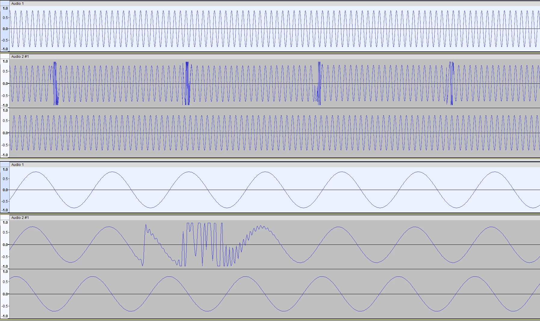

It works perfectly fine for a transform size of 1024 and 2048. If I make the transform / buffer size any larger or smaller the audio output gets corrupted. Output buffer delay is adjusted appropriately. On top you can see the 1 kHz sine wave that is fed into the unit, below that is the corrupted output of the left channel and below that is the output of the right channel (feeding samples straight though inside the ISR).
What I have already done trying to fix the bug:
I verified the FFT and IFFT is working correctly by feeding a known array with a known output into the transform functions - works.
Simply copying the input buffer to the output buffer in the while loop works as well.
The really weird thing is, if I simply uncomment line 155 where I memcpy just the input buffer into another totally unused buffer, that has nothing to do with the transform, it suddenly works for all transform sizes.
So I assume this must be some kind of memory access issue. However at this point I am absolutely clueless what could potentially cause this behavior or how I could debug it. I would highly appreciate if somebody could point me into the right direction!

Update: It is enough to just read from audioInputBuffer in the while loop before doing the FFT transform to make it work. No memcpy, nothing, just reading from it. If I don't do that, it's the same issue. What on earth is going on there?

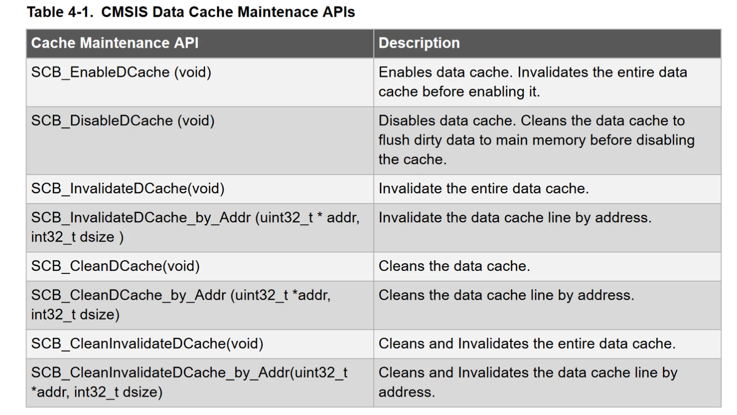

How does your design take into account cache coherency & data buffer alignment?
JP_ama
JP_amaAuthor
July 22, 2023
It doesn't because I don't have to? I'm using an F4 which doesn't have a L1 cache. As far as I know it only has a D- and I-cache for flash memory access. Please correct me if I am wrong or if I didn't understand the concept.
The data buffer contains 32 bit floats. I double checked in the memory viewer during runtime that the buffers are aligned and not overlapping. I also checked for wrong array boundaries, but everything seems fine as well.
Thanks!
Johi
Senior II
July 22, 2023
@JP_ama, I am afraid you are correct and therefore I am not. Should have known as last week was investigating STM32F407 SDIO and therefore D-cache is flash only as stated in RM0090. Had some problems long time ago with STM32H735 where DMA did abnormal things from time to time related to cache coherency.
MM..1
July 22, 2023
Hi, in your code i dont see any time control. Any code on audio samples stream can work only if calculation speed > as stream speed. Seems your code with float calculations is slower and based on size of buffer corruption occurs on every N buf...
Simply your half and full calback copies dont endet fft arrays...
Too check volatile requirments for your defs. Array not volatile is optimized out maybe

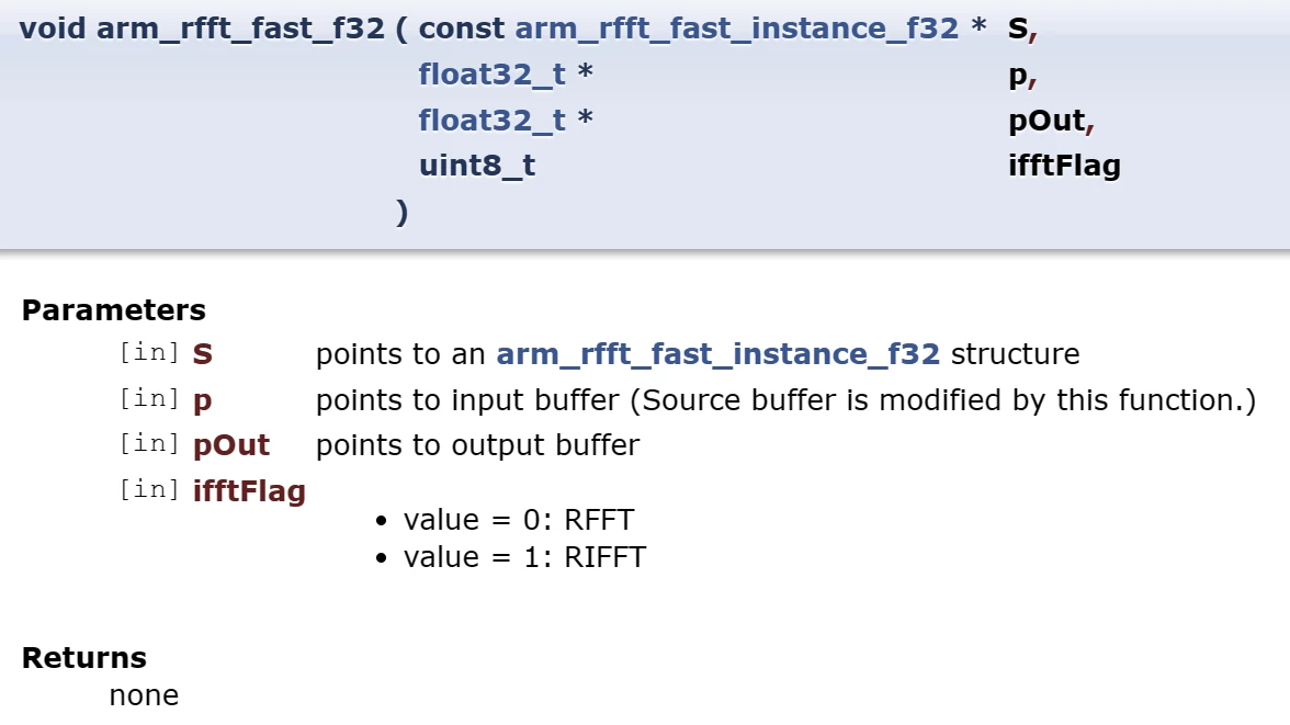

The output buffer array index is running 512 samples behind the input buffer index (for 4096 transform size). That's about 11 ms. The FFT calculations take roughly 2 ms. I measured and verified this. Not sure if there are nicer ways to do this though.
I tried making the input buffer array volatile. However the volatile qualifier gets discarded in the arm_rfft_fast_f32 function call (compiler warning). So I'm not sure if this is doing much. But I am suspecting something like this causing the problem as well.

Ok 2ms is one or both fft and this reflect to your graphs. In this 2ms you send to output intermediate calculations of fft instead real data, because you dont have time management. Too i recommend double output buffers swap...

@MM..1I was wrong about the calculation time, this was for 1024/2048. For 4096 samples the FFT + IFFT takes 5,6 ms. I have a timeframe of 9 ms (512 samples). As I said 30 us pre-delay is enough but even adding 1 or 2 ms of delay works fine as well. So it's plenty of time to do the actual calculations.
So after all it seems to be a timing problem indeed. But I still do not understand why I need this pre-delay though. @Piranha I am already double buffering. When the dataReady flag is set, it takes 90 ms until the offset variables are modified again. I drew a small sketch of my buffer structure to visualize this. Where is the flaw in my thinking?

 arm_rfft_fast_f32(&sMyFFTInstance, &audioInputBuffer[inputBufferOffset], fftBuffer, 0);
 arm_rfft_fast_f32(&sMyFFTInstance, fftBuffer, &audioOutputBuffer[outputBufferOffset], 1);
your info is in parenthes
JP_ama
JP_amaAuthor
July 25, 2023
I am aware of that. But still, it is reading and modifying the half of the buffer, that is currently not written by DMA. So why is this a problem?
