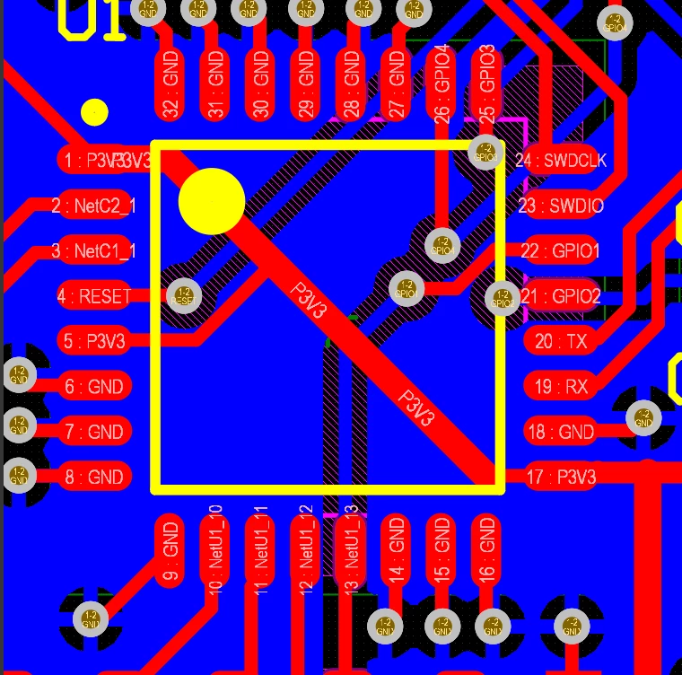

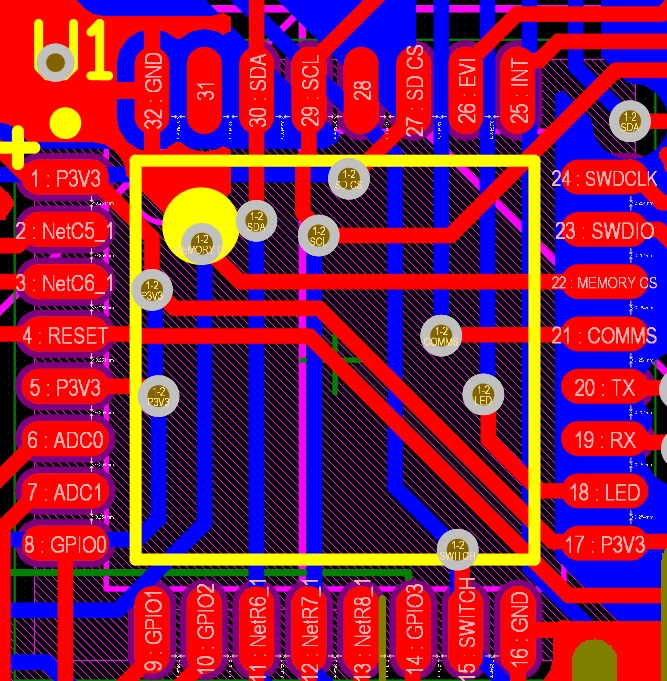

My STM32L051K8T6 gets stuck in an infinite loop in HAL_Delay(1000); but I know its a hardware problem, not a software problem. Where should I focus my hardware debugging on?
I have used this same chip on a previous project and managed to toggle an LED on and off using HAL_Delay(1000); function. I copied the same code across to my new project board, uploaded it successfully, toggled the LED on successfully but when I step into HAL_Delay(1000); it gets stuck infinitely.
I know it's a hardware problem because the same code works on my other board.
The thing that confuses me is the
  • The STM32 allows me to upload my firmware and step through it, so I know the MCU isn't broken.
  • I know the code works, as it works on my original board (different design, same chip).
What I'm asking for is there any places I should be looking for that might cause this problem on a hardware level, system clock problems?
Admittedly the MCUs are different batches, however I'm sure its just a layout problem.
This is the layout of the original board that works:
This is the layout of the board that isn't working:

From your hardware layout, check pin 31 - it looks like that is the BOOT0 pin and should be pulled to GND. On the board that is not working, you have left it floating.
Hope this helps

ARyan.4
ARyan.4Author
October 17, 2021
Hi all, I wanted to just confirm that the problem was indeed hardware as I expected. As soon as I pulled the BOOT pin to ground (like pin 31 in the first photo was, but not the second), as per JVart.1's response there was no more issues with HAL_Delay, and everything runs as expected. (No code was just, just grounded the pin). Thanks all for your help!
