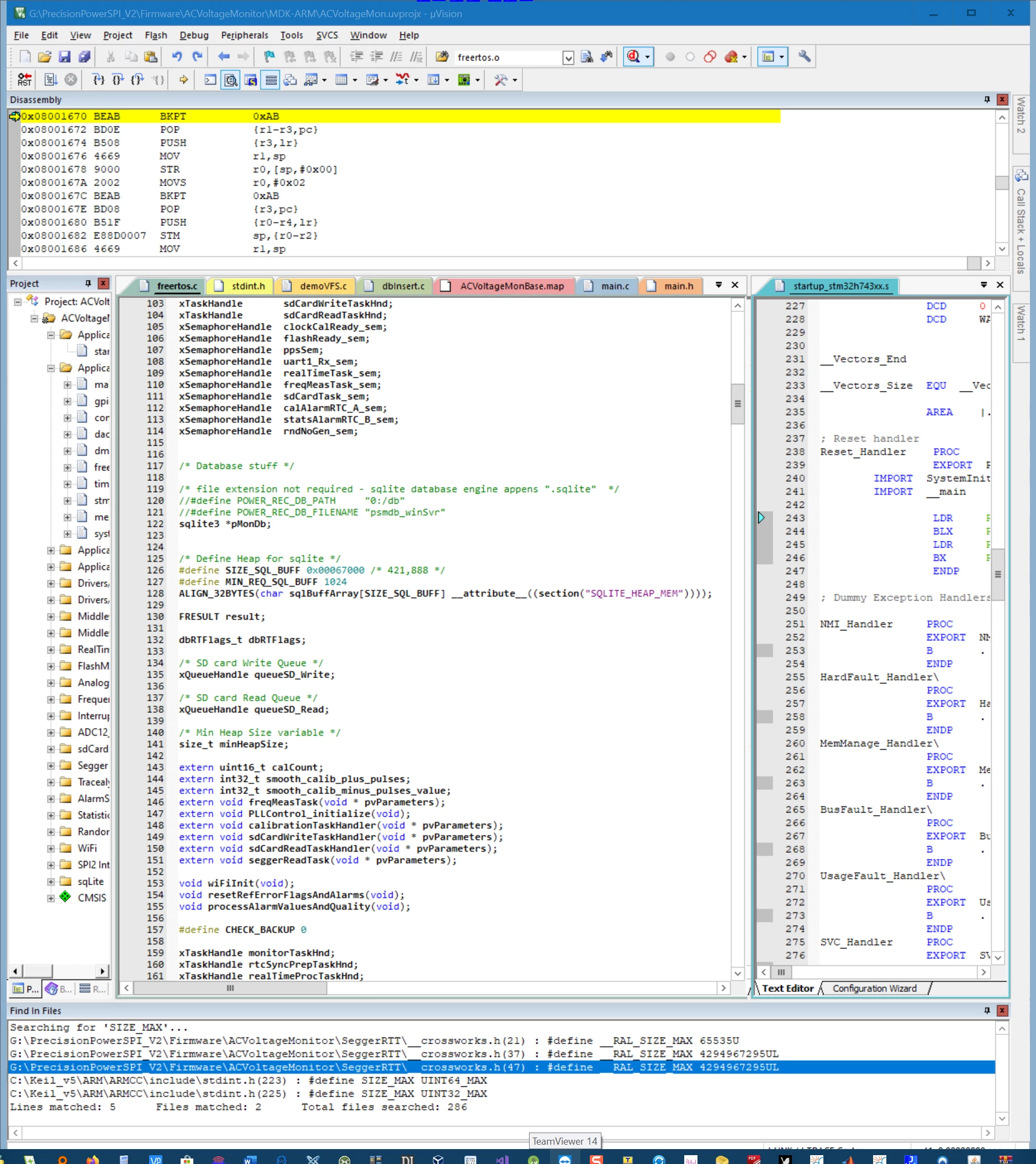

My STM32H743VI Application Runs to a debug instruction in the start-up code
When I start my program from the uVision debugger the code runs to a debug instruction in the start-up code.
It requires three run push buttons to get it past the debug instruction. The program then works perfectly.
This problem only happens when I include a large AXI ram buffer for sqLite which I use for storing real-time data.
The variable is defined thus
/* Define Heap for sqlite */
#define SIZE_SQL_BUFF 0x00067000 /* 421,888 */
#define MIN_REQ_SQL_BUFF 1024
ALIGN_32BYTES(char sqlBuffArray[SIZE_SQL_BUFF] __attribute__((section("SQLITE_HEAP_MEM"))));

I have used scatter files like this in most of my projects and never have come across this problem.
As soon as I comment out the code that calls up the variable the thing works. Minus sqLite of course.
Any ideas?
I was going to publich this project on this site as it uses sqLite really well and I know a lot of people want to use sqLite, but are intimidated by the need to write the VFS to talk to fatFS and to get the whole thing to compile. The sqLite DB works really well with write ahead logging. It's robust against power failures causing data corruption and for simply saving data without running large select queries it is very fast.
Any hep on this would be greatly appresiated as I have spend a day and a half trying to unravel it.

Tesla DeLorean
Guru
Jan 11, 2020 12:41 PM UTC
This BKPT is because there is a printf or puts in the code somewhere. If you have a debugger UART, or want to use the SWV channel you will need some fputc() code.
Also you should enable SRAM clocks.

Garnett.Robert
Senior III
Jan 13, 2020 1:57 AM UTC
Hi Clive
Yehh! I figured it out.
I start the RAM Clocks in the Main program.
To fix it i did what this link advised:
https://mklimenko.github.io/english/2018/11/02/disable-semihosting/
It' was the semihosting capability built into the compiler. (I am not using microlib can't remember why)
You turn semi hosting off with some macros:

Additional Info:
The reason this problem occurred is that I switched from armcc V5 compiler to armcc V6
