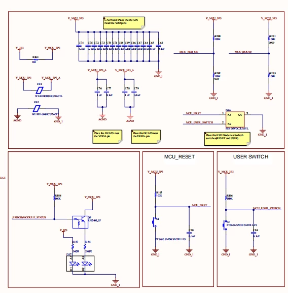

While powering up all of my Microcontrollers were getting shorted, checked the voltages of all the capacitors and the MCU has a dedicated power line . And checked the ripple and initial power up data,everything is fine only. But still the MCU getting shorted. Is it because of the batch of the purticular MCU (

First of all, I would like to ask you to use a higher resolution when uploading the images so that you can still read something.
By the way, what do you mean by "getting shorted"? If it is original devices from ST and not fakes, I can assure you that all STM32s are fully tested and functional.

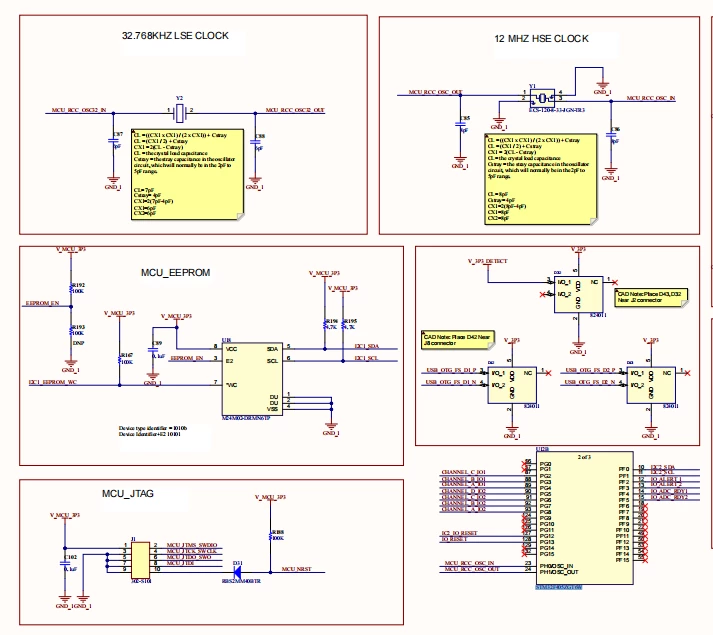

What type is used for Y1 (practically unreadable)?
BTW - what is the reason for
  • the diode on MCU_JTAG, pin 1?
  • the pull-up of 100k at its anode?
  • another pull-up of 100k at MCU_NRST?
Regards
/Peter

Y1: ECS-120-8-33-JGN-TR3
D31(RBS2MM40BTR)- Diode on the JTAG pin is for unidirectional action
  • the pull-up of 100k at its anode? In order to make it default state as high

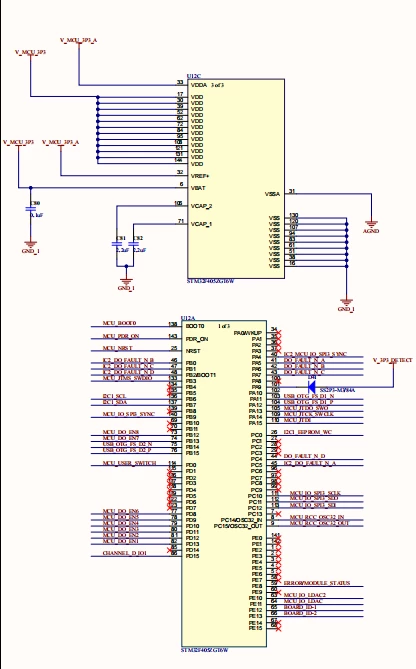

And that diode at pin PA9 (?) looks suspicious, if PA9 is configured as output with 0V.
And have you double-checked all the VCC / GND pins?

And that diode at pin PA9 ? (SS2P3-M3/84A)- It is to show that it is a unidirectional action
And have you double-checked all the VCC / GND pins? Yes double checked everything is fine only

It certainly has nothing to do with your problem, but it is not necessary to provide NRST with a pull-up because there is one internally in the STM32 (see RM0090, section 6.1.2).
