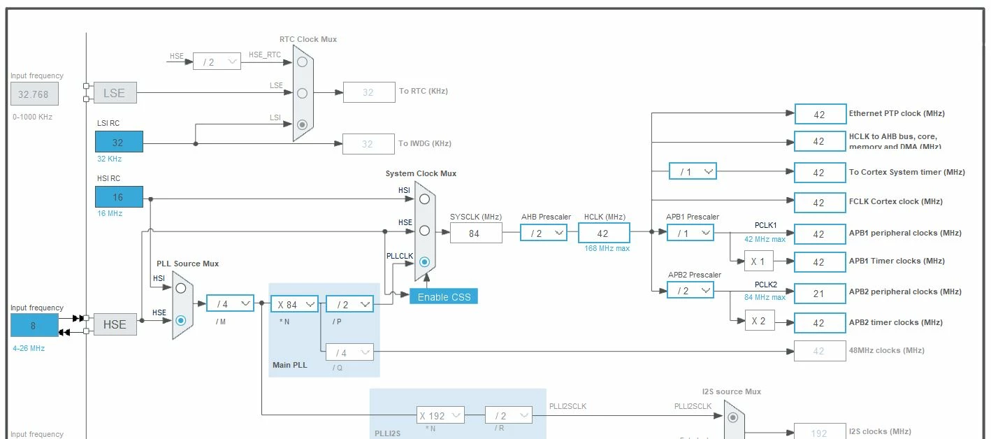

PinOut F405:
SPI MOSI - PA7
SPI CLK- PA5
LCD_DC - PA6
LCD_RST- PC4
Code: see attached file
IOC setup: see attached picture
Im using an external crystal at 8Mhz

Typically you clock APB2 at least as fast as APB1. I don't know this will cause a clock-inversion issue, but would perhaps be worth checking if doing Memory-to-Memory with DMA2
If at 40 MHz would need to prescale in the SPI peripheral to get 10 MHz externally.
10.5 MHz might be too fast for the display, although there might be some margin. I'd start with 5.25 MHz, or clock the MCU at a lower rate to get the gearing needed.

SystemClock_Config(); will determine your MCU speed, that of the AHB which connects to things external to the core (CM4F), and the APB1 (lower speed) and APB2 (higher speed) peripheral buses.
Which SPI will determine which APB is in use. The SPI Prescaler in the peripheral itself will determine how the APB clock divides down to get to the SPI CLOCK (SPI1_SCK) to the external device.
SPI1 on the STM32F4 is on APB2, you're clocking this at what speed?

July 8, 2024
So after some use of the oscilloscope I could see that the SPI clock and MOSI were writing the correct byte values for initilisation of the LCD. When it came to writing a buffer I noticed that my DC pin was not going high. When I reviewed the code I could see that the wrong port was specified. I changed it to the correct port and bingo, we are working!
