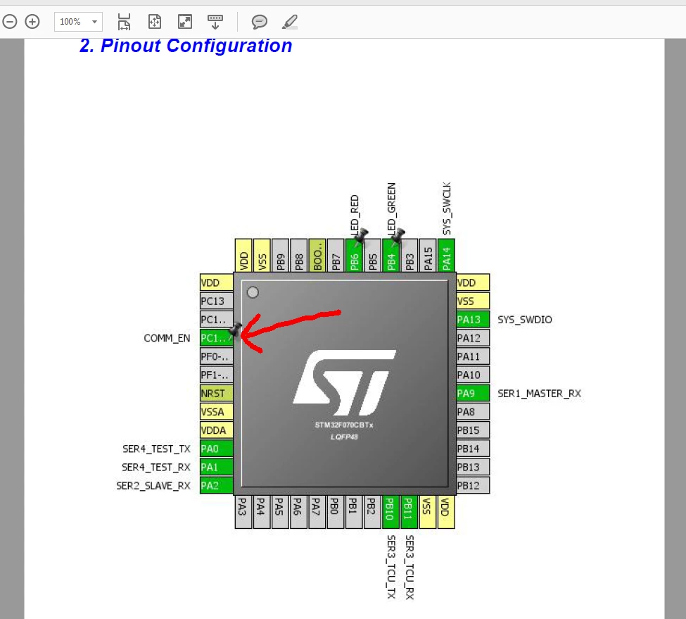

A minor bug in STM32CubeMX 4.21.0 (Win7, Adobe Reader 2017):
pin names don't fit in generated report PDF when 'locating stake' for user label is used. See attached screenshot

    However, it is a choice that we made not to have the fit in for the pin name that is the best solution, on my point of view.
    Or else, we would have some pins larger than the other...The pinout view would be a mess.
    For the moment, it is not planned to change the pinout view.

    Could you please attach your .ioc file?  I will highlight this issue internally to our CubeMx team.
    Thanks

    Here I attach the .ioc.
    It happens also on-screen in CubeMX at low zoom levels. It seems this 'low-zoom view' is stored into pdf. It may depend also on system font and graphics driver.

    It's nothing to do with
    'locating stake': it happens at standard pins as well. The graphical representation of a pin is too small to fit pin names especially long (e.g. 'PC15-OSC32_OUT') names.

    I see your point.
