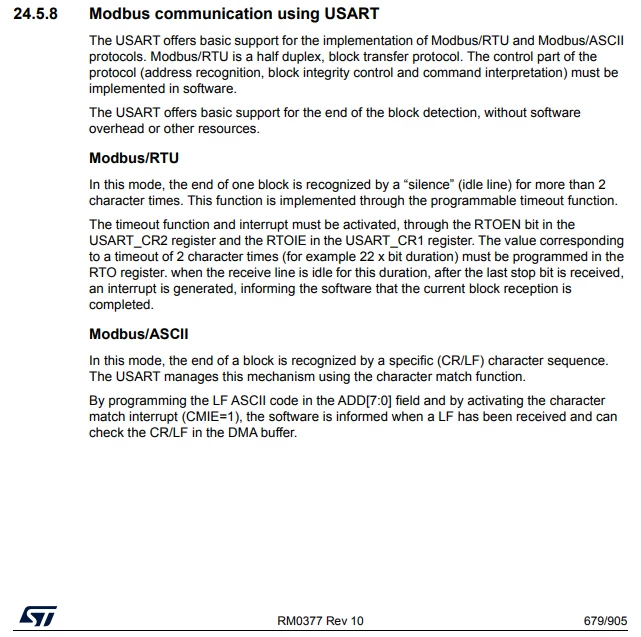

We are planning to make a board using a STM32 MCU in a Modbus application. What we need is a Modbus-RTU. We found that STM32F030 can satisfy our needs and cheap enough but it does not support Modbus. Could we use STM32F030 in this case by special software additional design or we should find another MCU supporting Modbus? If we could use it then we need support about the additional software design. Would you please support us?

We know that Modbus-RTU is a UART link, but we found that some MCUs(For example:STM32L031K6) supporting Modbus have 2 register-bits for the Modbus mode. They are RTOEN and RTOIE. Refer to the Reference Manual, these 2 bits need to be set to activate. But we couldn't find the same register-bit in STM32F030's document.
Can we achieve the function by software without the register-bit? Are there some knowhow documents about this issue?

@PacteraHW2018 wrote:
We found that some MCUs(For example:STM32L031K6) supporting Modbus have 2 register-bits for the Modbus mode. They are RTOEN and RTOIE. Refer to the Reference Manual
Indeed:
But, as @jlag said, that's just a "nicety" - nothing that you couldn't also achieve using other standard means.
