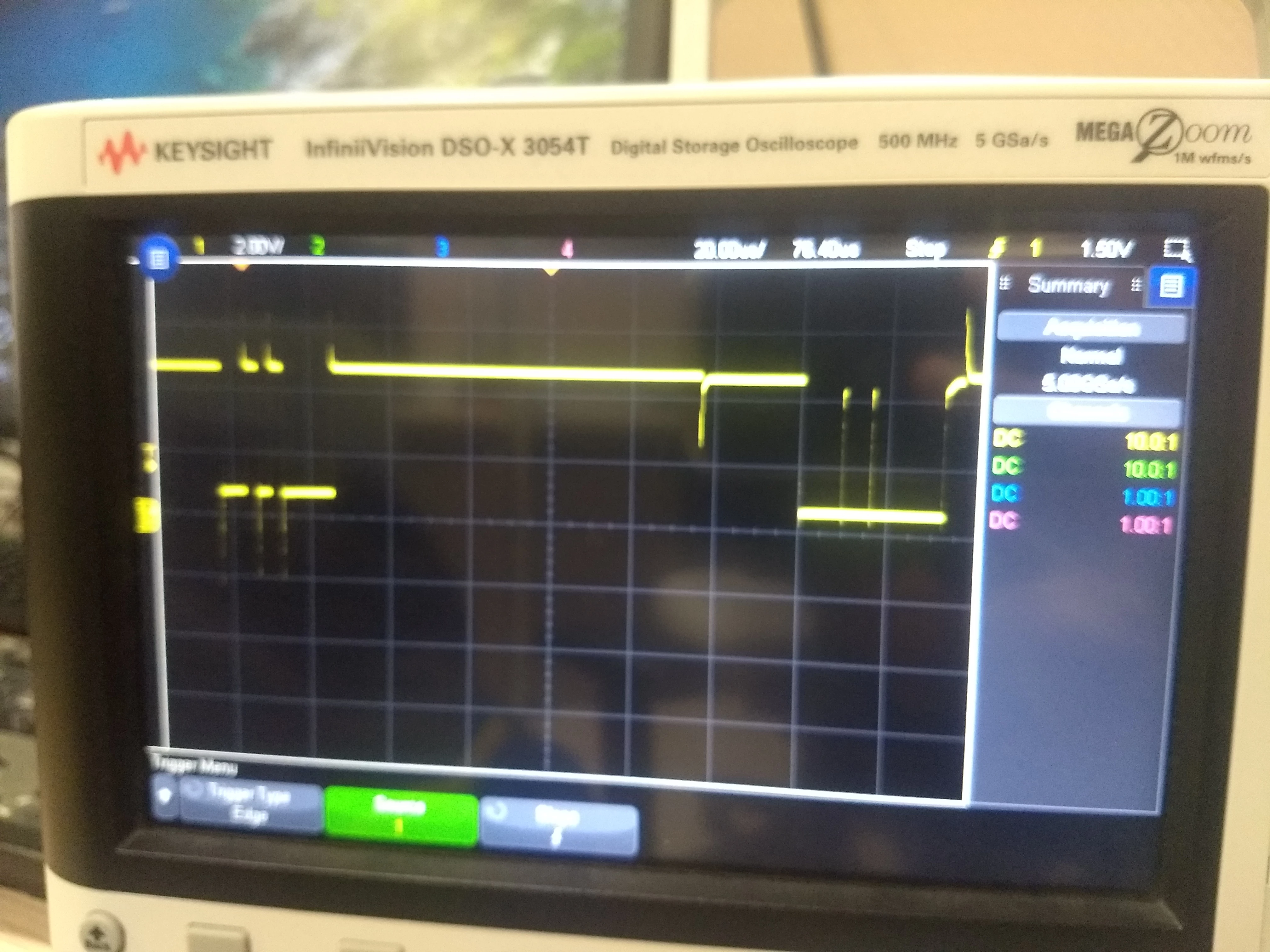

i can able to receive correct data at 115200 baud rate.
but can able able to get at 312500.
i have checked with oscilloscope. only spikes is coming instead of logic high. please check the image.
thanks
Roushan

IMHO the spikes are unacceptably high/low. That is because of unmatched impedance. The faster you go, the more impedance matters.
https://en.wikipedia.org/wiki/Characteristic_impedance

And the first frame on that picture looks quite OK, what's that?
Also, what exactly is your hardware?
Rkuma.1964
March 23, 2020
-> first frame is transmitted data and second is received data whatever we have send.
-> i am using rs485 for the communication.

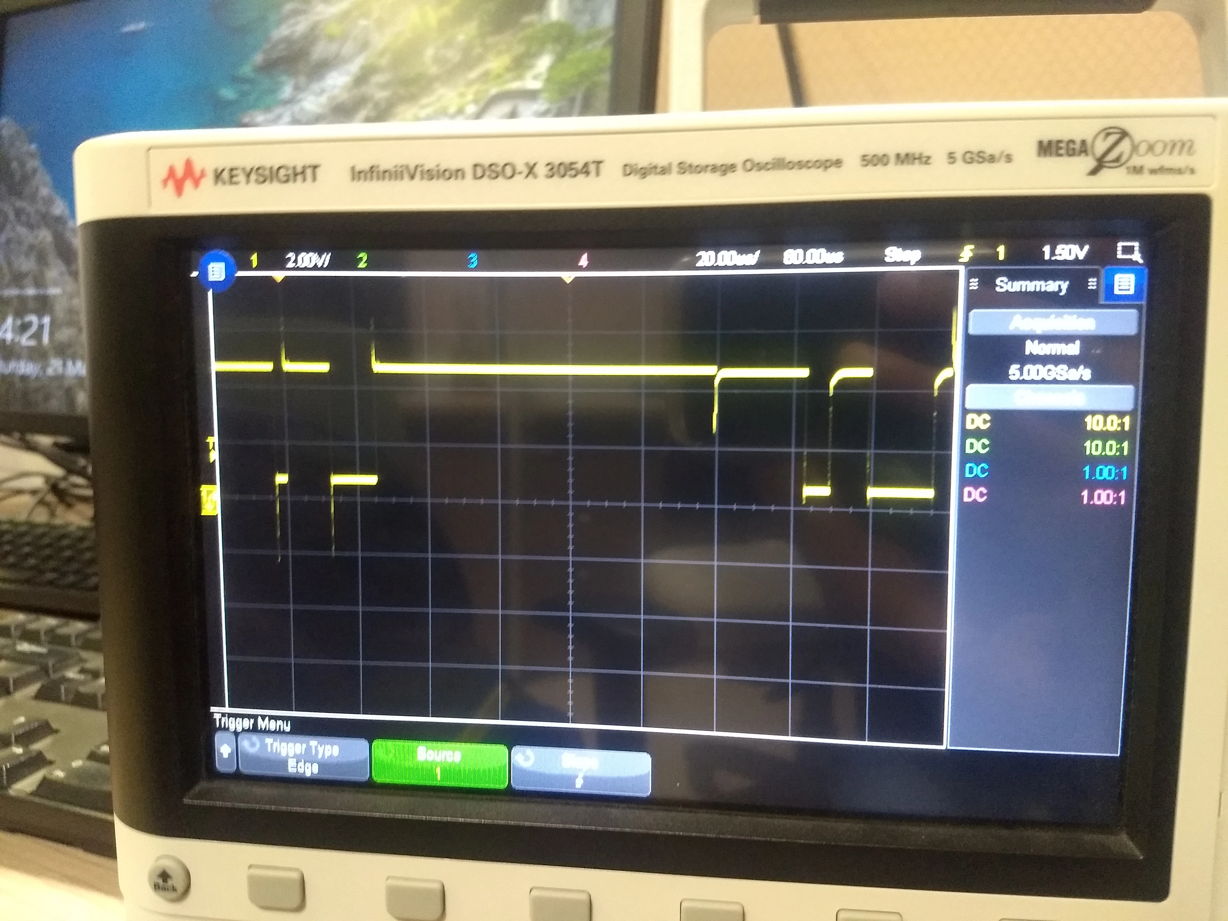

But it is working perfectly at lower baud rate i.e 115200
-> image attached.
baud rate 115200 setting;
 huart2.Instance = USART2;
 huart2.Init.BaudRate = 115200;
 huart2.Init.WordLength = UART_WORDLENGTH_9B;
 huart2.Init.StopBits = UART_STOPBITS_1;
 huart2.Init.Parity = UART_PARITY_NONE;
 huart2.Init.Mode = UART_MODE_TX_RX;
 huart2.Init.HwFlowCtl = UART_HWCONTROL_NONE;
 huart2.Init.OverSampling = UART_OVERSAMPLING_8;
 huart2.Init.OneBitSampling = UART_ONE_BIT_SAMPLE_DISABLE;
 huart2.AdvancedInit.AdvFeatureInit = UART_ADVFEATURE_NO_INIT;
 if (HAL_MultiProcessor_Init(&huart2, 10, UART_WAKEUPMETHOD_ADDRESSMARK) != HAL_OK)
  Error_Handler();
 if (HAL_MultiProcessorEx_AddressLength_Set(&huart2, UART_ADDRESS_DETECT_7B) != HAL_OK)
  Error_Handler();
uart peripheral clock is 10MHz.
thanks
roushan

The signal for first frame doesn't seem to be properly terminated.
Rkuma.1964
March 23, 2020
prev image is working and it is properly terminated.
i can able to see the correct reply .
roushan

RS485 can be tricky. Are you using properly shielded twisted pair cable? The termination is definitely wrong.
Also, have you considered that RS485 or the processor you are using isn't really up to the task?
If it works at a slower baud rate there is probably something else wrong, altho HAL is most certainty not helping.​
